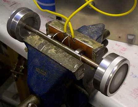

The Ball-Bearing electric motor
This interesting but unfortunately not very useful device produces motion from electricity without magnetism being involved. It operates purely by thermal means, so it works on AC or DC, and the motor can rotate in either direction, determined by the initial spin which is usually required to get it going.
It simply consists of two ball-bearing races on a common conductive shaft, with the outer ring of each race being connected to a high current, low voltage power supply. An alternative construction is to fit the ballraces inside a metal tube, and mount them on a shaft with a non-conductive section (e.g. two sleeves on an insulating rod). This method has the advantage that the tube will act as a flywheel.
This picture shows the motor running. There is a rectangular white label on the right-hand flywheel, being blurred by the motion.
I've seen that before, VERY cool... of course requiring massive amounts of current is a drawback, as well as the crazy heat generated... but from what i've heard they can spin incredibly fast...
that and i imagine that if you were to stop the shaft (or not give it an initial spin) that it would probably just weld itself together
Yes, It can't run for long at a time without seizing up.

how fast does it turn, and how much current does it draw?
It not gonna develope any useful torque either
nicve proof-of concept but apart from that
Give me Brushless DC or SR machine anyday
