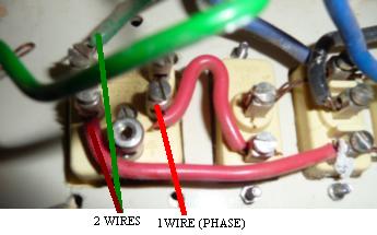

................but why aren't your items in question earthed?
Earthed it now...I had to remove the Socket and proper the earth connection wire.
and just to my curiosity, i have another question:
Why the neutral Pins have 2 wires connected (RED AND GREEN)?
Its comes out from the wall so, i'm not able to make out what it is...
And there's a two way switch next to it?
IS IT SIMPLY CONNECTED, BOTH NEUTRAL?
