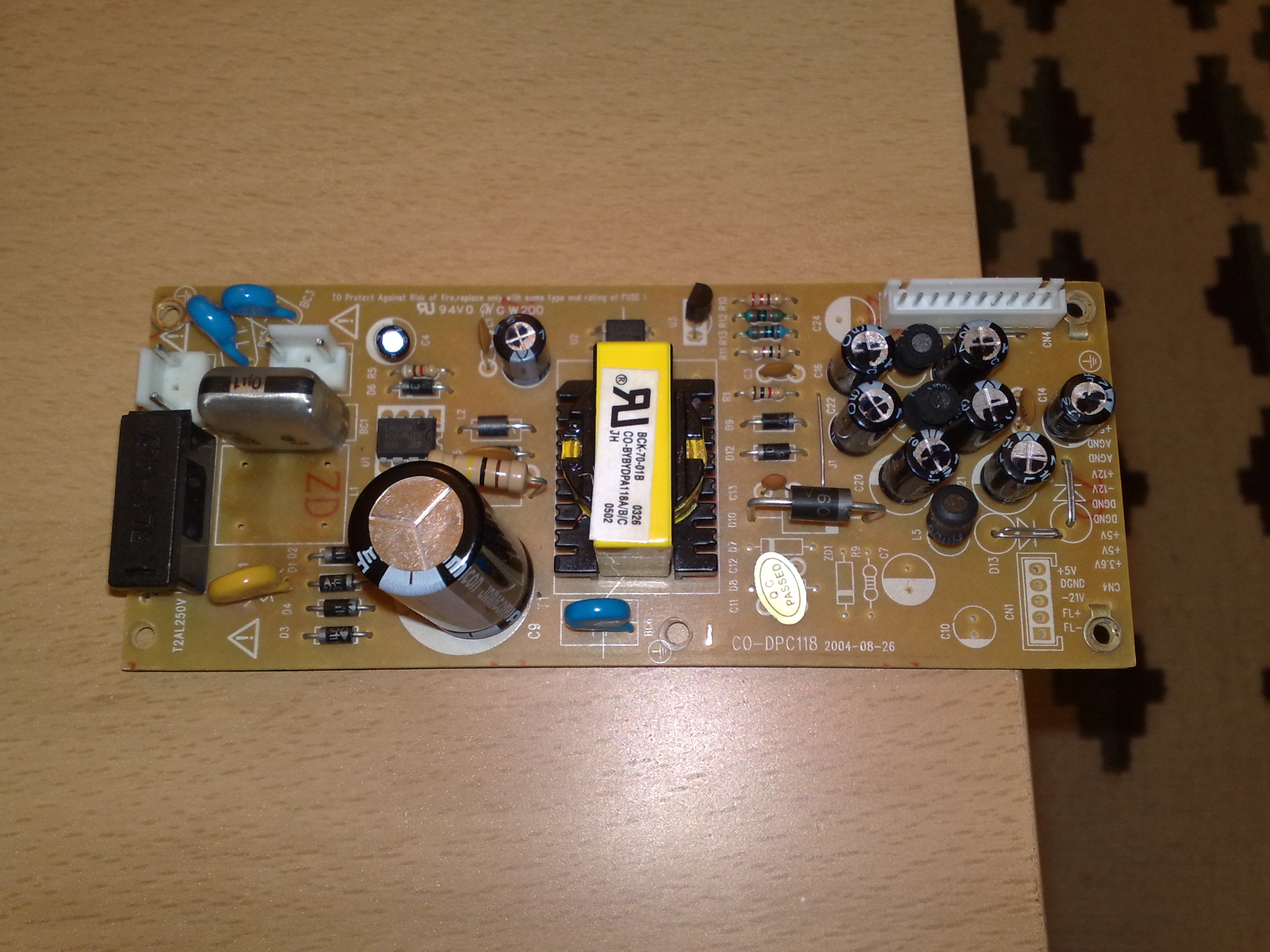

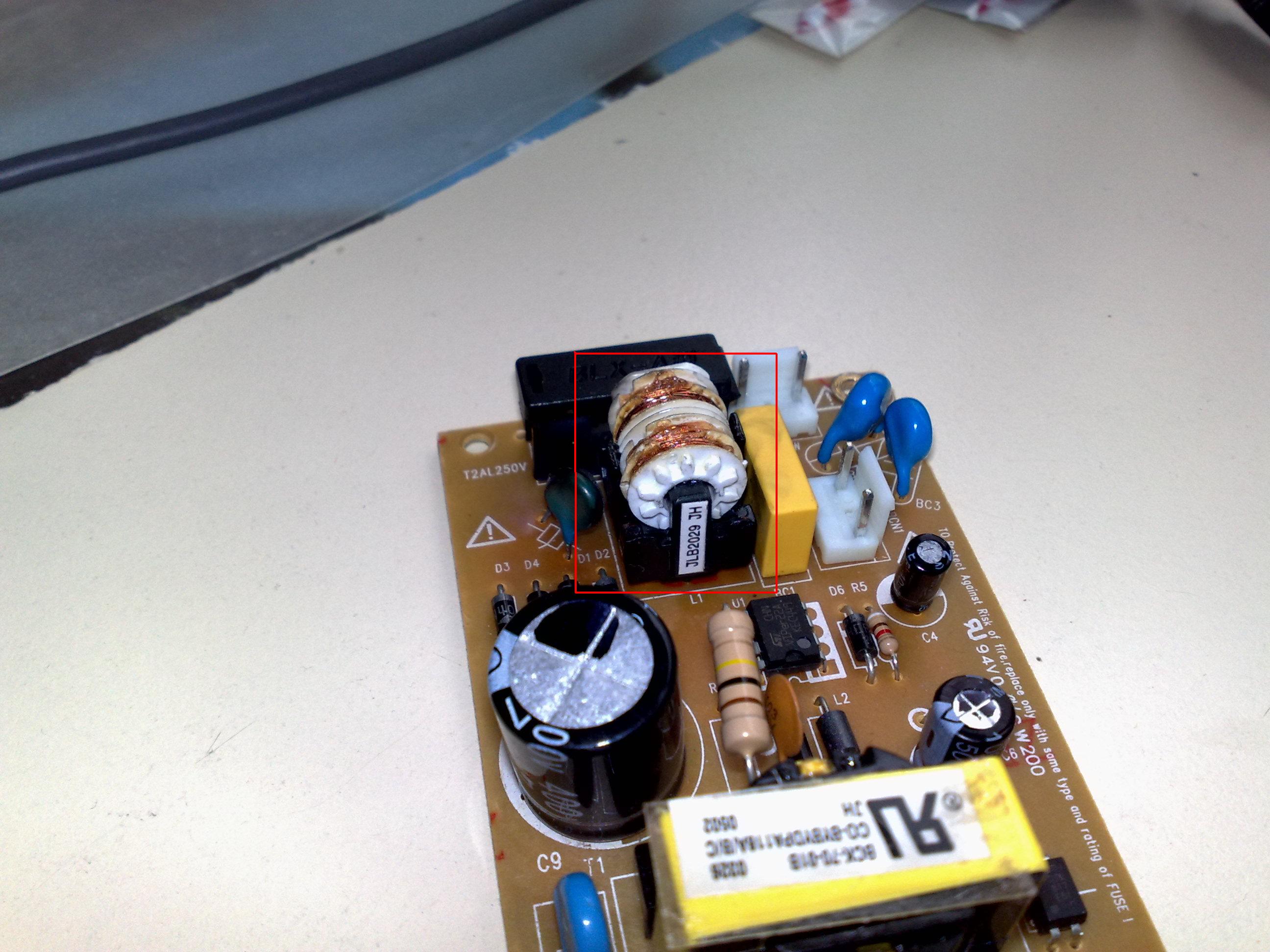

Hi guys,
me and a friend of mine are trying to repair a DVD player (Elta 8845) and are stuck with a burned out part (coil) we don't know and so far no body can tell what it exactly is and does and what we should replace it with.
Please look at the picture and tell me what that could be and where to find anything to put instead?? It has 4 connectors and is on the input side of the circuit.
Thanks in advance :)

No, really, It looks to me the burned part is an inductor in the switching power supply. It may be repairable, the player not the part, but depending on the cost of the player it may be cheaper to replace.

It's just a mains filter, you can simply short it out, and everything should work fine - this will prove nothing else is faulty, but you should really replace it with a similar filter - it's just to keep interference OUT of the DVD player, and prevent the DVD interfering with anything else.
Basically they started adding them for CE compliance, before that they often didn't bother.
How did you determine that it is defective? It does look like it got warm, but this isn't often fatal to the filter. It is, however, usually fatal to the mains fuse (and is an indicator that something much more important down the line has failed).
thanks.... I was close to making this conclusion myself but I didn't dare :) will try
Well... to start with - all 4 in/out wires are disconnected due to the heat :))) the endings aren't visible anymore to reconnect - all I could do is just cut somewhere and reconnect... would that bring anything?
other then that - I already replaced all other part that looked burned out, incl. the fuse.
UPDATE:
So, I tried to short it out and ..... tadaaam :D it started..... BUT when I connected it to the TV:
1. The picture was a bit redish
2. the signal was instable - the TV was jumping from TV to AV and back... sometimes working properly for 2min and then jumping back and forth again....
so - I tried to repair the burned out inductor/filter by unwinding the wires a bit to be able to connect the 4 ends back to the connectors... kind of a tricky work with such a small wire.
and the final result: The DVD player works as new!! not jumping, no picture problems (so far at least ;) )
Total costs: 10€ (4 parts exchanged, 1 repaired)
Thanks to all of you and especially Nigel Goodwin for the tips!!
