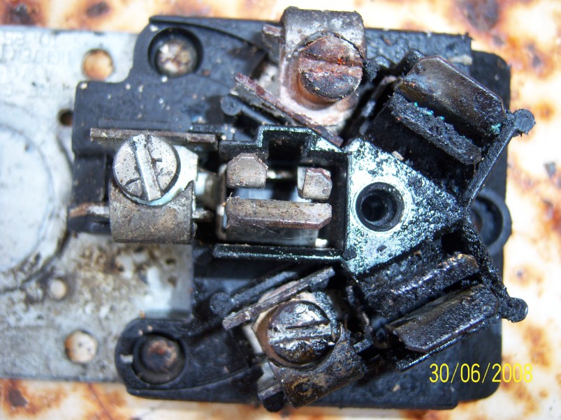

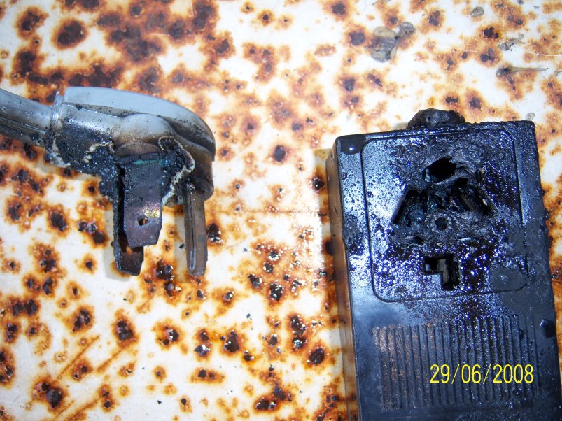

The 220 outlet box for my dryer caught fire last night, both it and the plug were damaged, but fortunately nothing else. I saw the flickering light on my security camera. At first I thought the RGB light I built a few weeks ago was malfunctioning. It's really bright, but fades slowly, and no flicker. So went out and checked. The outlet box was flaming up pretty good, really sucked because it had been raining earlier, everything around it was wet. Had to grab the dog, he's a curious puppy, and its 220 and fire. Flip the breakers, went back out, but still burning pretty good, covered it with some scrap aluminum, died out quickly.
This was really strange, as I ran this 220 about 14 years ago, and it's been through hurricanes. The rain we've been getting hasn't been anything spectacular, why flame up now? Will admit that I don't much about house wiring, but do it anyway. This was my first 220 run, which involved considerable guessing, surprised it worked. Can only guess that some water got in, maybe a bug or something.
Going to Home Depot when it opens, and get a new box, and see if they have a longer cord for the dryer. If not, I'll just replace the cord. Yeah, going to just put it back as before. If I get the longer cord, I can put it inside the house, if not, I'll have to shelter it, so it doesn't happen again. Lucky I was home, and had the security cameras, could have been much worse. The wires seem fine, weren't even warm to touch, even with the flames.

If the wire connections loosen up they can cause increased resistance or arcing which can lead to a fire. In the article at this **broken link removed** they talk about vibration causing a loose connection to get worse and increase the temperature to about 400 C. I wonder if vibration from the dryer could have done the same.
I don't think it was vibration, maybe years of oxidation and a little rain. I do laundry once a week, usually Sundays. So, it was sitting for a week, also rained some pretty much everyday last week. The wires inside the outlet box weren't scorched, melted, or burned. I just left them as they were, when I installed the new box (drying clothes right now). Will have to take a closer look inside the box later, only removed the wires last night under the light of a flashlight. More concerned about making it safe to flip the breaker back on.
The new box is all metal, grounded, and firmly attached to a concrete block wall, inside the house. Shouldn't be a problem again.
The fire was likely caused by a high resistance contact, either between one of the wires and the socket, or between the socket and plug contacts. With, perhaps 15A going through the wires, it doesn't take much resistance to create a lot of heat.

Nope, all copper, brass connectors. Still seems pretty weird, all wires were fine, just the black plastic cover on the outlet burned, which melted the plastic on the dryer plug (didn't really burn). I re-used the 220 line from the breaker, looked clean and bright, insulation looked good. Just did two loads of laundry, so no immediate faults. The dryer cord plug was still solid, but slightly exposed. Didn't want to risk it.

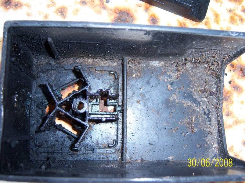

Actually, it the box wasn't anchored to anything, just laying on top of a concrete block, next to the dryer... The dryer cord wasn't long enough to reach all the way to the wall, let alone inside the house, so I ran the 220 out to it. It's had a lot more then a few drops of water dumped on it over the years, several hurricanes have passed over us. Will post a few pictures of the inside of the outlet. Still haven't taken a close look, was just glad to get the dryer running, and my clothes done.
Pretty obvious from the second picture, a good amount of dirt an debris insid the cover. Not really bad for 14 or so years, but enough to start a fire...
