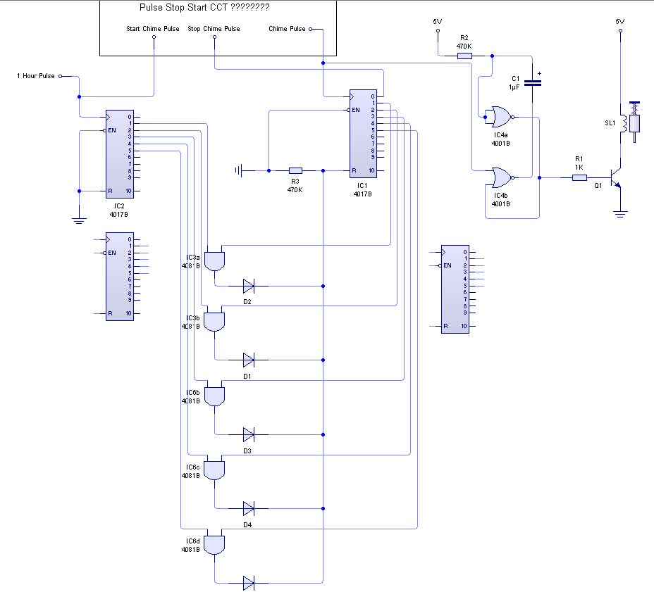

and want to design a cct to chime the hours using an old Grandfather clock bell. I plan to use a solenoid or hammer attached to a relay armature to strike the bell.
I have come up with the cct below but have got stuck. I need a cct to stop pulsing when IC1 is reset (pin0 logic1) but to start pulsing when an hourly pulse is received.
I have 1 second and faster pulses available from the clock or some sort of timer or astable could be used to drive the chime pulse as long as it is stopped and started as above.
The cct should work as folows every hour IC2 steps on 1 driven by the hour pulse. The hour pulse starts the Chime Pulse and continues to chime untill the O/P pins of IC1 matches the count of IC2 when it is reset via the relevant 12 AND gates. This in turn stops the Chime pulse.
IC1 and 2 would be linked to 2nd counters to enable the chime to count 12 then the hourly count would be reset.
Can anyone spot an easy solution or is there a better cct in existance already?

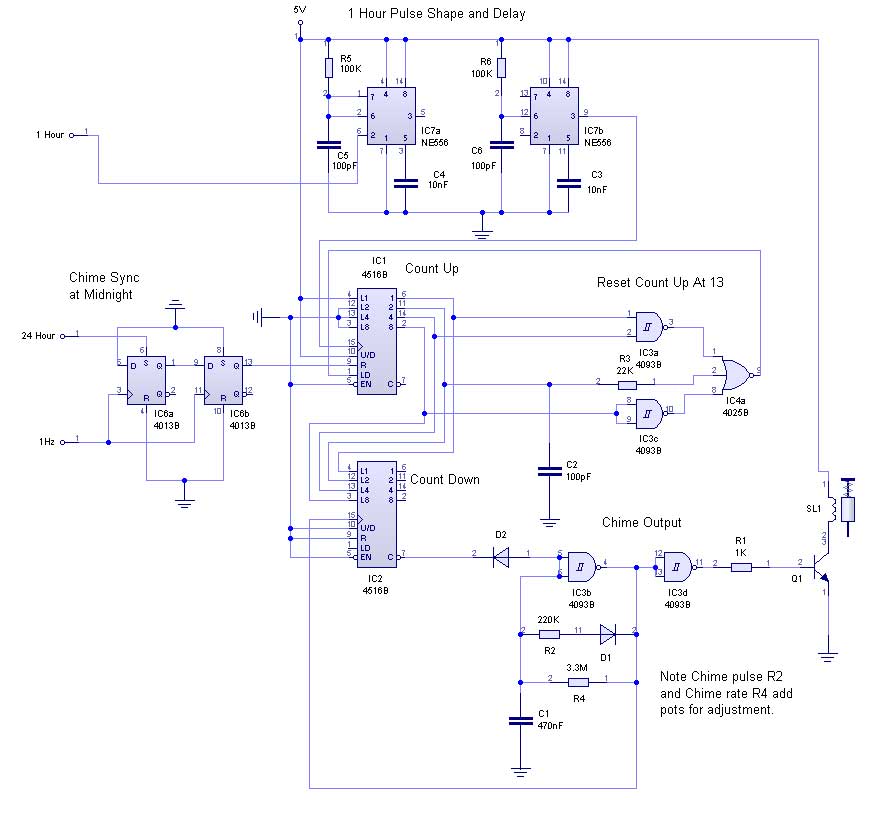

Here is the basic idea. In order to finish it, I need to know more about the digital clock.
1. Can you access the Hour digit in binary? If so, IC2 is not required, if not,
2. Can it output a pulse at 1 o'clock? If not, can it output one at 12 o'clock?
3. If the answer to all of these questions is no, how do you propose to keep IC2 in sync with the digital clock? It could occasionally slip.
4. Can you obtain a 1 Hz signal from the digital clock?
Forget these questions, I just noticed you posted a link to the digital clock circuit. I'll modify the circuit to suit and post later

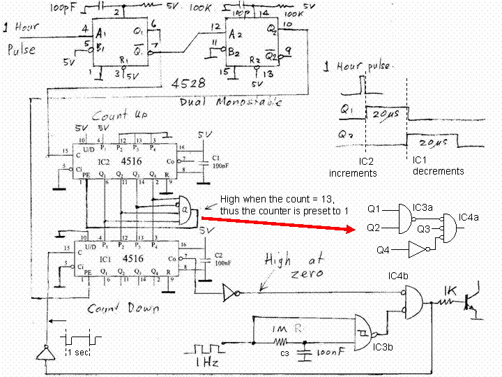

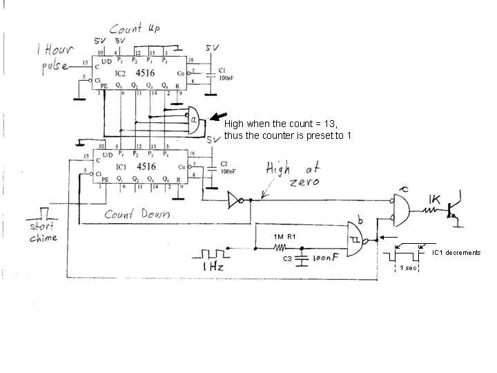

Circuit description (I suggest you download the data sheet for the 4516 counter)
IC1 is configured to count down, IC2 to count up. They increment/decrement at the positive edge of the pulse input to C.
When PE is high, the counter is set according to the state of inputs P1 to P4. So when IC2 reaches 13 (as detected by the gating labelled a - I'll draw the detail when & if necessary), it is rapidly preset to 1.
After chiming, IC1 is held at 0 since Co is low - edit, there is an error in the circuit here, I'll fix it after your response.
The "start chime" signal is generated from the 1 Hour pulse by a differentiation circuit not shown. This presets IC1 to the current time (IC2 holds the current hour). Thus Co goes High and so IC1 decrements after each chime pulse.
The Schmitt Trigger NAND gate (b) generates short pulses (as set by R1 & C3) to set the length of the chime pulse.
Gate c is a NOR gate (performing the AND function) that allows the 1 Hz pulses to reach the transistor while Co is High.
For example, at say 2 o'clock, IC1 is set to 2 and decrements after the first chime pulse (ie. at the positive edge of the signal from b).
After the second chime pulse, it decrements to 0, so Co goes low thus closing gate c and preventing further chiming.
Edit, see next post

Here is the revised version. IC3 is a 4093 Quad Schmitt NAND and IC4 is a 4025 Tripple 3 input NOR.
The monostable is necessary since the 1 Hour pulse will be fairly short and thus must be extended.
The inverters can be made from unused gates.

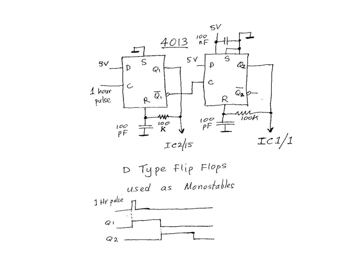

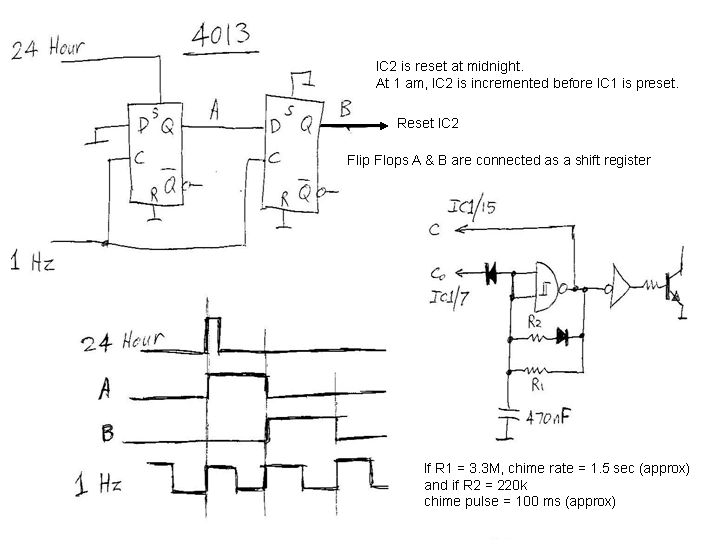

I have posted 2 suggestions.
1. a method to reset IC2 at midnight.
2. a chime pulse generator.
I feel that a 1 Hz chime pulse rate will be too fast. This one allows you to set the rate and pulse length by selection of R1 and R2. I have shown approx values to give you a starting point. Note that the CMOS Schmitt Triggers have wide spreads and so you will have to either "select on test" or insert pots. You may also have to change the capacitor value, but it will vary both pulse length and rate. The other advantage is that this configuration requires one less inverter.

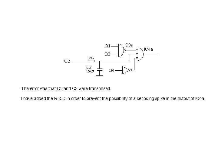

Oops, there is an error in the gating shown previously.
I have also added protection against the possibility of a decoding spike.

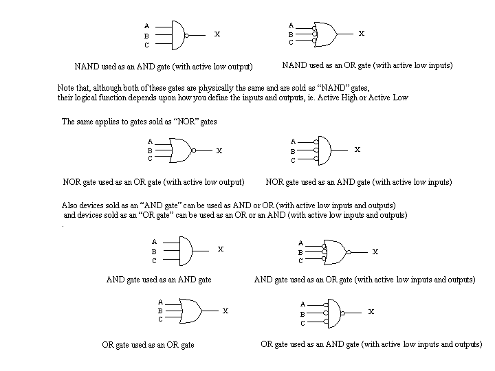

Here is a paper I wrote some years ago that may be of interest.

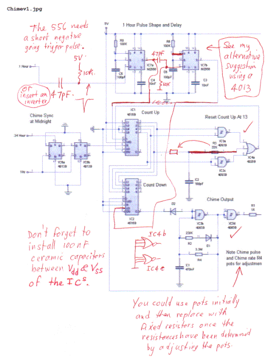

Chime CCT awaiting a few queries.
I have a couple of queries the NOT Q output on your 1st monostable can this be replaced with a NOT Gate from Pin 5 of IC7a on my diagram?
Also the gate before the resistor on the transistor is this a not gate with active low IP?
Will repost diagram with corrections later.
Brett.
I have a couple of queries the NOT Q output on your 1st monostable can this be replaced with a NOT Gate from Pin 5 of IC7a on my diagram? No, the 556 needs a short negative going pulse to trigger (see the marked up circut). However, see my alternative suggestion.
Also the gate before the resistor on the transistor is this a not gate with active low IP? Quite right, ideally the inverter should have an active high output.
