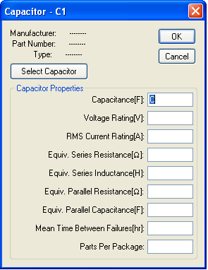

Linear Technology's SwitcherCAD III has these optional parameters for a capacitor. Polarized and unpolarized have separate symbols, but they have the same properties window. You would have to get the parameters from a datasheet of the part you are simulating. As has been pointed out, the characteristics during reverse bias are not modeled, because reverse bias can be destructive, or at least can cause parameters to change and/or degrade.
