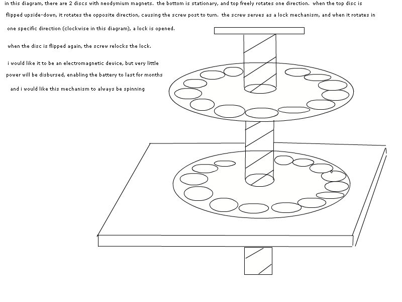

i am trying to build an electromagnetic lock with 1/2" x 1/8" Neodymium N45 magnets. here is a simple diagram for what i'm trying to do. i need any suggestions, input, or ideas related to this problem.

OK what is it for. If it is spining all the time the batterys will run out fast. You may be beyond the laws of physics with this one. Andy

OK you need to elaberate on your intent. Will you flip the disk? Looks like you are just trying to make a pancake motor. Its not a lock but a actuator. Andy
i would rather not flip the disc, but change the polarity. i sure do like to make things more complicated than they really are. i should just use previous suggestions and buy an actuator or H motor. i may also just use the drive from a cd/dvd player.
David; Pancake motors are vary weak and have vary low tork. You would need some complicated timing to switch the coils. Look them up but thay probly will not do what you want. Andy
im scrapping this idea completely. to get the effect i want, i've completely changed the design and gone with a much more efficient way of achieving success. to open my drawer, im using a spring mechanism that latches shut with the neodymium magnetic bar. a solenoid will release the magnetic bar, shoving the drawer open. i'll have to manually close the drawer and reset the lock, but that's fine.
You will be using alot of power to keep the lock closed.
Consider using a mechanical method,like a cash register drawer. nice, easy, and secure. (And already designed and cheap to buy)
To open and close a small drawer I suggest to make the drawer spring loaded and lock it with a pulling solenoid.
Small cash boxes are normally made that way, which I used in my shop. I made an adapter circuit for the serial interface of my PC and every time the final input was made the solenoid was triggered opening the drawer.
The solenoid does not have to be strong (power consumption) since it just has to unlock the drawer.
