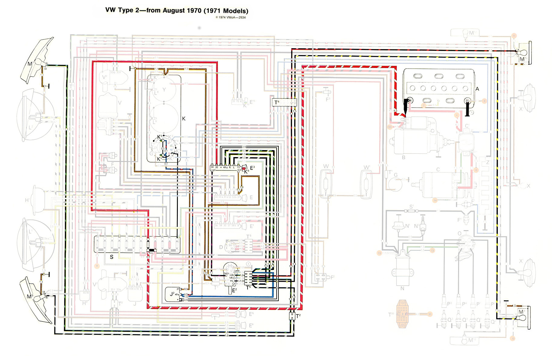

Hi, My VW Bus has quit flashing its turn signals and emergency flasher. The problem seems to be with the 3 terminal 30 amp relay 12 volt emergency flasher relay. I have one on order but I am just wondering if a Solid state flasher circuit could be designed to use instead.
There is 12 volt supply. Ground. and Load.
It would need to handle something like a 2 ohm (not led) rather incandescent bulb load at 12 volts with 1 second or maybe a little less on cycle.
I would love to see some design ideas Thanks:

Thanks for your interest, I had to check the Schematic it looks like the Emergency flasher switch E1 powers J2 the flasher relay in turn signal mode when it's off and on too for that mater when on it somehow ties all 4 lamps together So J2 is the Flasher Relay for both. For now I have the flasher relay jumpered and the turn signal do light that way just no flashing.
I'm not having any luck at all thinking of a way to use N channel Mosfets to do this a Multi-Stable Oscillator configuration would work but would need 2 separate loads.
Emergency Flasher Mode:
Turn Signal Mode:

The Replacement Flasher arrived and it works well the only problem is it makes the LED Flasher Indicators glow just a little.
Does it flash at the correct rate? It is rated for 2 or 4 bulbs at 21 W each (plus some side repeaters). I would expect it to flash faster with the smaller load that LEDs take.
You may be able to stop the LEDs glowing by putting a resistor in parallel with each side. 100 Ohms, 2 W or greater power rating would be fine.
It seems perfect! The LED's are only in the Dash indicators. It's just running the 4 21W bulbs. I am going to go through and clean my light fixtures soon and will see if it knows when a lamp is out. It's Supposed to be an OE part for the 1971 VW But it flashes at the same rate just running the turn signals as it does all 4 Emergency Flashers.
The faster flash with just one light is a deliberate feature, so it is either faster or normal, there is not a continual range of flash rates. I would not expect any difference between 2 bulbs working and 4. If you look at my earlier post about the flasher unit designed to detect the 3 lights in use when a trailer was connected, it had two distinct features (faster flashing and additional warning light).
I don't understand why the LED dashboard indicators glow. Is that when the indicators aren't in use? The conventional lights in parallel with the dashboard indicators should take away any leakage current.
