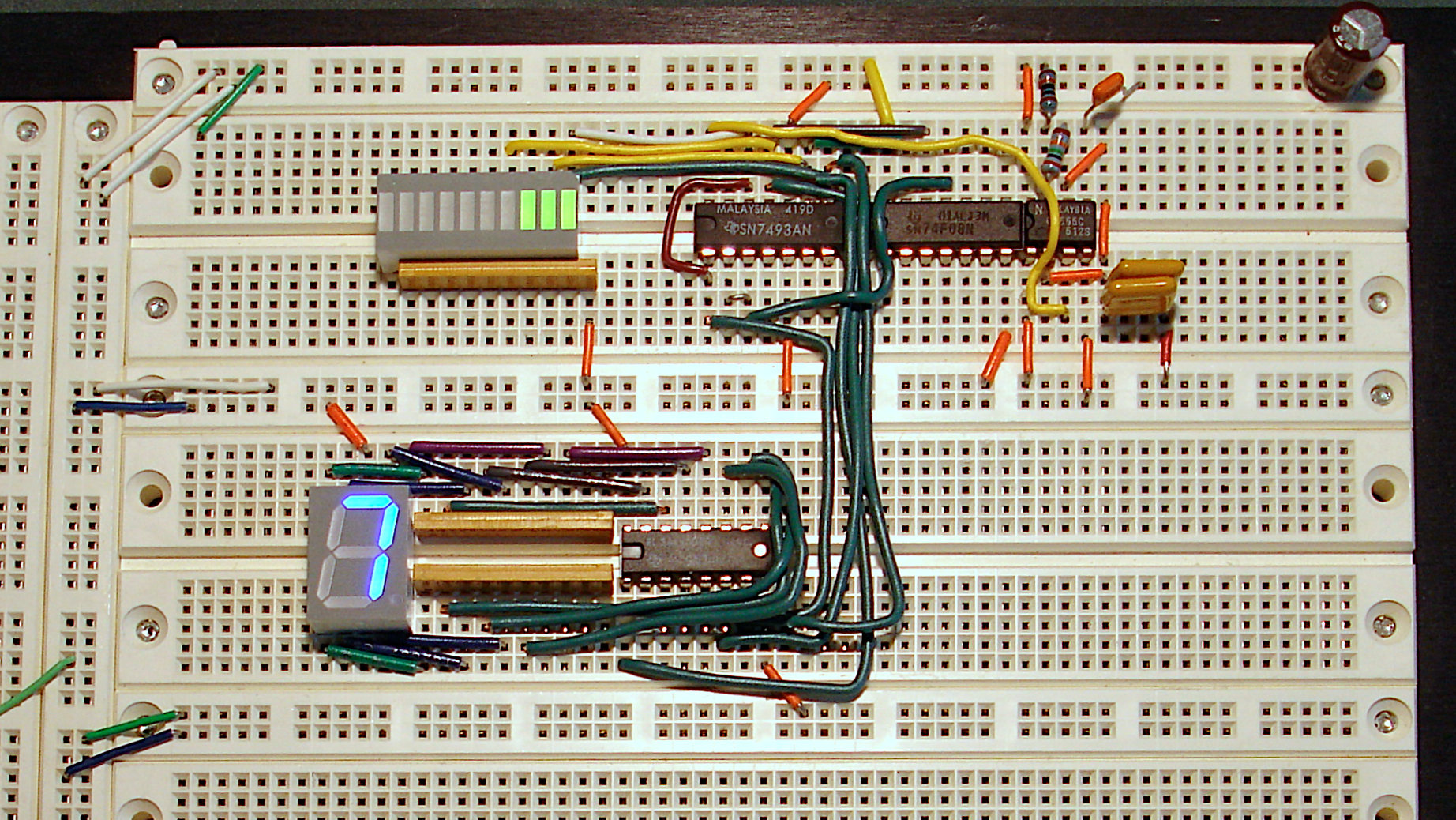

Hi
In this breadboard circuit, you can see that the wires are laid out nicely and they seem to fit tightly into breadboard holes. Where do I get these wires? What is their gauge? I see that they are single stand wires but still I don't know how to search for these wires. Please help me. Thanks.

I have large reels (100metres) of 0.6mm single core wire in three colours and just cut what I need as I need it.
This of course may be a big outlay for you.
The wire kits as suggested above are a good idea, but will not have the wire you want when you want it!
For a CHEAP solution, have a look for some discarded CAT5 ethernet cable which has several single strand wires.
Strip the outer insulation sheath, and you have lots of single core wire to cut as required.
Where did you get it? They might have small reels. Could you please link me to online retailer, such as Amazon, for such reels? Thanks.
The following are also good options.
KISS: **broken link removed** (in form a kit)
RoboWanabe: https://www.hobbytronics.co.uk/cables-connectors/breadboard-wire (sold per meter)
