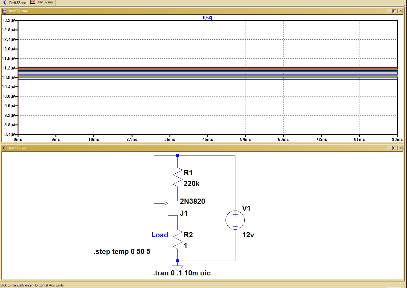

Dear friends,
I know this topic is for 10 years ago,
but one of my friends wants to design such a apex locator for his final college project
and he doesn't find any thing useful.
Can anyone give a schematic reference please?
Thanks in Advance
OK
In our researches, we found that commercial products use a constant 11uA (micro Ampere) current source to measure the potential voltage between file clip and lip clip.
Now can anybody suggest a circuit to make such a small precision highly stable constant current?
Any idea is appreciated.
OK
Now can anybody suggest a circuit to make such a small highly constant current?
This option is simple and reliable.
Use a 1% HS metal film resistor for the 220K. It maybe necessary to select the 220k best value for 11uA
Thank you dear ericgibbs, we'll test it.
