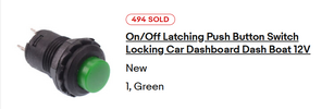

small project going on here. basically i need 4 momentary switches connected to an electronic dice (i have the dice already)
this is for a game - each player has a push switch (think they are called momentary switches so basically push it once and it goes off again). anyone can press their button at anytime to roll the electronic dice. pictures below show my dice, battery pack, on off switch and also the push button switch , basically need 3 more of these like the switch in the other pic,
basically no idea how to power and wire up if you have any ideas please. thanks so much

Yes, you need for momentary buttons - not the "latching" type you link to.
All the extra buttons would connect in parallel (same two wires to every button) and the two wires then connect to the two terminals of the button on the dice board.
ok so wire in 4 switches direct (well parallel) to where the current momentary switch is. and the battery stays in the same place with the main on / off switch?
