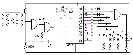

This will be a very cool thing to have. :D I need schematics for "Electronic Dice." The components that will be visible outside of the box, (I like to have my projects enclosed. :) ) will be two 7-segment LED displays, an SPDT slide switch, and a momentary pushbutton. The pushbutton will be the trigger for the random number. The seven segment led displays will display the number. And here's the big thing, the slide switch, will determine if the led displays will show a random number between 1-6 or 2-12. I am very excited about this, so can someone help please? :D Thank you very much. You have no idea how much this means to me. I LOVE THESE FOURMS!!! :D :D :D
This is not a 7segment solution, but maybe good startpoint...

There is a "problem" if you expand the schematic to simulate two dices though. The random number will really be random between 2 and 12 (or 'between 0 and 10 and shifted left by ignoring the LSB for ease of construction' :) ). With real dices however, the chances are not equally spread. For example, throwing a '7' can be done in 6 out of 36 possible ways (1-6, 2-5, 3-4, 4-3, 5-2, 6-1), while throwing snake eyes will only happen once every 36 times. Well theoretically anyway.

Sebi, I think I might do that, it looks pretty cool how it makes it look like real dice. Matrix dice I think they call that right? Anyway, I could just have the switch be a SPST. Instead of SPDT. The SPST could simply switch the power off for the 2nd dice. However, I think I'd rather do the 7-segment thing... I think
