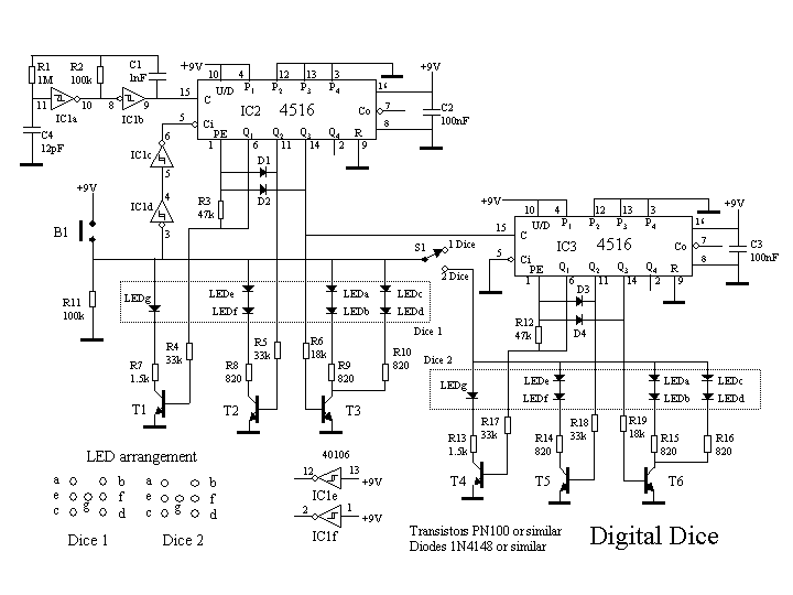

It is difficult to advise you without having a circuit to look at. And, I don't have a data sheet for the 4517.
Did you install bypass capacitors, ie. 100 nF caps across the IC supply pins? See the attachment.
If these are not provided, strange effects can occur due to coupling via the supply line.
The attachment is an ED that I did some time ago. It is similar to yours in that it counts from 1 to 7 and then is preset to 1, so it effectively counts from 1 to 6 since it does not remain in state 7 very long.
Note that one or two dice can be selected with the switch. So there are 2 counters and I did not use 7 segment displays, I used LEDs configured as a dice is configured.
Len

FreeRange_Human said:
Hmm ok, ill try to post a schematic..... anyone know a good prog for circuit drawing?
I did the above in PowerPoint. Save it as a .ppt initially and then when ready to submit, Save as a .gif
