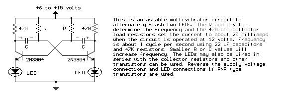

I want to build a electronic dog wistle!
I want it simple!
T have the shematic for a modilator but i dont know what walues i need to oscilate at 25-40 kHz
It can be just a oscilator as long as it oscilates at 25-40 kHz.
2 x 1k resistors and a .01 cap will give you 48khz with a 555
1k trim pot, 1k ohm, .01 cap & 555 should cover that range.

I have a potencimeter but i dont have a variable resistor.
Your in Australia and im in Evrope sending the thru mail can be expesive
I will try whith a potencimeter. and use the smalest cap i can find lets say 3
First i have to get the compnents.I think there in my junk box.

I dont have a 555 ! :cry:
But a got a 5A Power NPN transistor.Perfect for amplafifing!So i can use a big speacer! :twisted: (Its a BUT11AF)
It works but just 2-3 dog got the beep.So i need to amplefy the signal.
