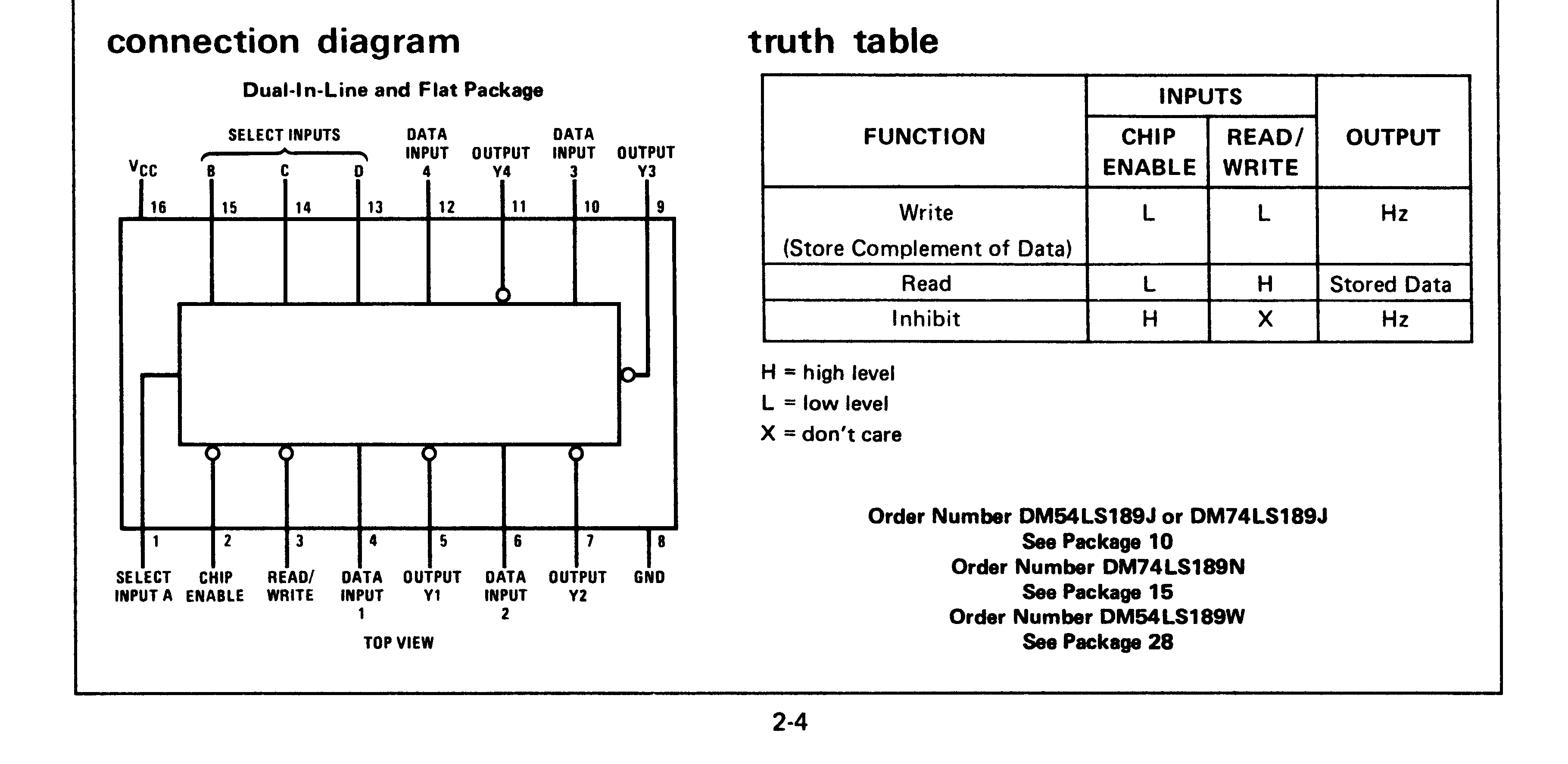

74ls189
Hi Earlbesario,
Here are the connections of the 74LS189 and the truth table.
on1aag.
