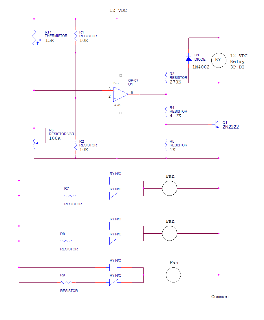

OK, something I noticed and you may want a second opinion is Your transistors will not be on or off (driven into saturation or not). As temperatures change the base current will change but slowly. While I did not look up the 2N3704 that would be my guess.
Given a choice I would use a circuit similar to the attached. Actually really thinking about it I would use a comparator like the LM339 and 4 thermistors. Regardless, the merit to using a comparator in there is ON or OFF with some hysteresis added. In the posted circuit even an old 741 op amp would work fro the comparator portion. I used a 3 pole double throw relay for hi and low speed. The resistors on the relay contacts would be chosen for low fan speed.

Wow, thanks for that, it now all makes (kinda) perfect sense :D
I think my original mistake was trying to get it to switch between different voltages before and after the load, rather than just put a resistor in series (which is of course the most obvious way of reducing voltage :rolleyes:)
One question though, one of the original goals was to have control over each fan (well, two-speed control anyway). I guess it would be pretty easy to do this, simply put a double throw switch before each limiting resistor leading to either the resistor, or straight to the fan.
Oh yeah, for the jet-engine mode switch (turn all fans to 12V), would the easiest way be to just stick an SPST switch across the collector and emitter of the transistor? This seems the most obvious, but I don't know whether it would be more efficient to do some jiggery-pokery with the op amp (say, put a switch + 15K resistor in parallel with the thermistor maybe).

In my example, just place a simple SPST switch across the thermistor. That would force the op amp to toggle high and turn on the transistor.
The way it works is as the thermistor gets warm its resistance decreases. That causes the voltage to slowly increase at the junction of the thermistor and the adjustment pot (think sensitivity). When that voltage exceeds about 6 volts (the ref set with the two 10K resistors) the op amp toggles high. So if we bypass the thermistor it will toggle high and turn on the transistor which turns on the relay. Now if you like switches then SPST switches could be placed across the resistors in series with the relay contacts. :)
Then you could run any fan (individually) on high at any given time.
Ron
Hmm, yeah I didn't really know anything about op amps but I looked them up and they seem pretty simple in terms of concept, a bit like a transistor switch I suppose, except it amplifies the difference between two signals.
Either way, I think I pretty much understand the circuit. The variable resistor is there to set the sensitivity of the thermistor, right? So if it's on low resistance, more current will go from the thermistor to ground and therefore a higher temp would be required to turn on the op amp; conversely if the variable resistor was on high resistance more electrons will flow to the op amp and therefore not such a high temp would be required to turn it on. At least that's the way I see it.
You may want to give this link a read with a focus on "Comparator Operation". You see it pretty much as it is. :)
You will see some good examples of using comparators.

Okay, well I just made a new design using the quad comparator and FOUR thermistors. Let's see the damage:
I didn't use relays as I didn't think it was necessary. My thought process went like this: duplicate original circuit's comparator parts four times. When transistors are off, current will flow through the variable resistors with knobs for adjustment. When transistors are on, current will flow freely to negative and so fans will be at max speed. Place each thermistor in applicable locations; bingo :)
It doesn't /look/ like there's anything wrong with this circuit. I actually built the part of the original circuit that included the comparator and transistor, and placed an LED in place of the relay, and it all worked as expected, which was encouragement :) I then tested my understanding by swapping the inputs on the comparator, and it also worked as expected (high/low based on thermistor signal was reversed). Even more encouragement :)

At a glance it looks good. Remember a single 2N2222 can handle a forward current of about 800 mA meaning it alone can easily drive a fan. If relays are used make sure to place a diode like a 1N4002 across the coil to act as a snubber. The merit of the relays is switching between low and high fan speed easily. Also, it would not hurt to place a .1 uF cap across the fan to eliminate some noise. I would build a single version of what you have and work with it from there.
