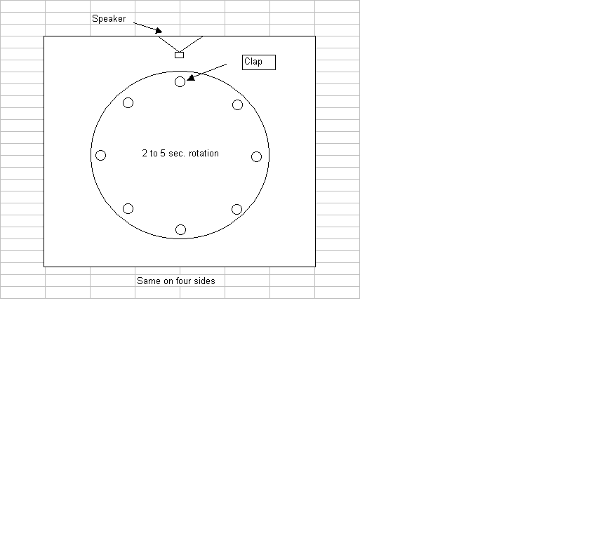

I think I know what you are after, but how about a picture to make sure.
I'm more of a hardware guy so I think I would do it with a counter. One count for each LED. How about a POP! for the sound. Similar to when you plug in a microphone to an amplifier. One big transient.

Thanks for taking the time with the drawing. That's basically what I had in mind although I think I might mount the speaker inside one of the rings of LED's. Not too sure about a 'pop' sound - perhaps a 'click' though.
OK. I think we can make the sound like that of plugging a mic into an open amplifier using the rising edge of the LED. I'll try to get a circuit today.

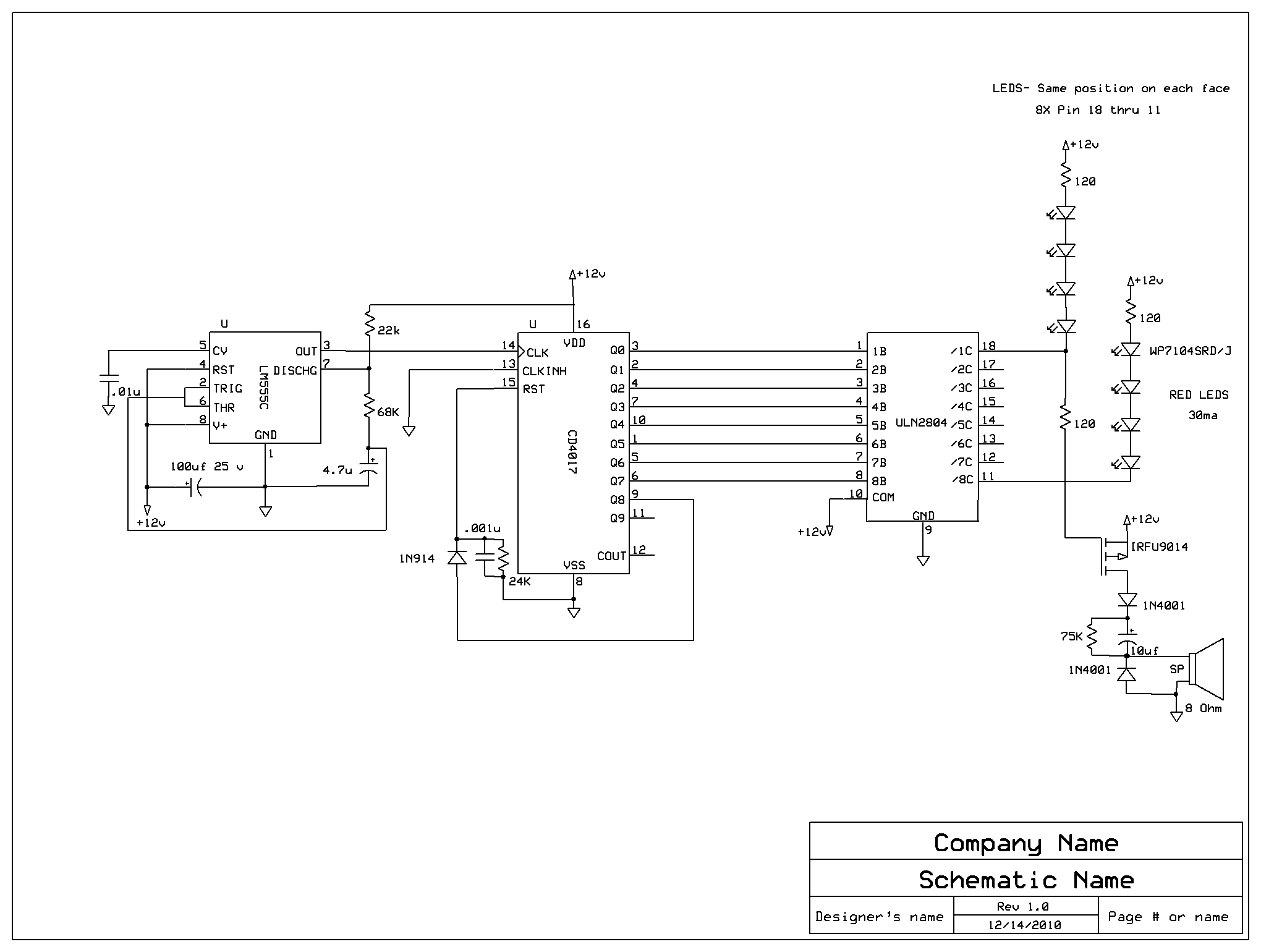

Here is one I think will work.
The 555 is just a clock (~.5 seconds)
The 4017 is a decimal counter that gets reset at 8.
The 2804 is a darlington driver to power up the 4017 to drive the LEDs.
The FET is to drive the speaker with the rising edge of count 0.
I used bright red LEDs so they could be run in series from 12 volts. Is red OK?
For clarity (and because I'm lazy) I just drew 2 of the 8 sets of LEDs.
Let me know what you think.

You are a star and many thanks for taking the time to look at this. What a great forum of expertise. I look forward to building this over Christmas. Many thanks to RadioRon too and will certainly learn more about programming. BTW, is everyone on this forum called Ron - :)
