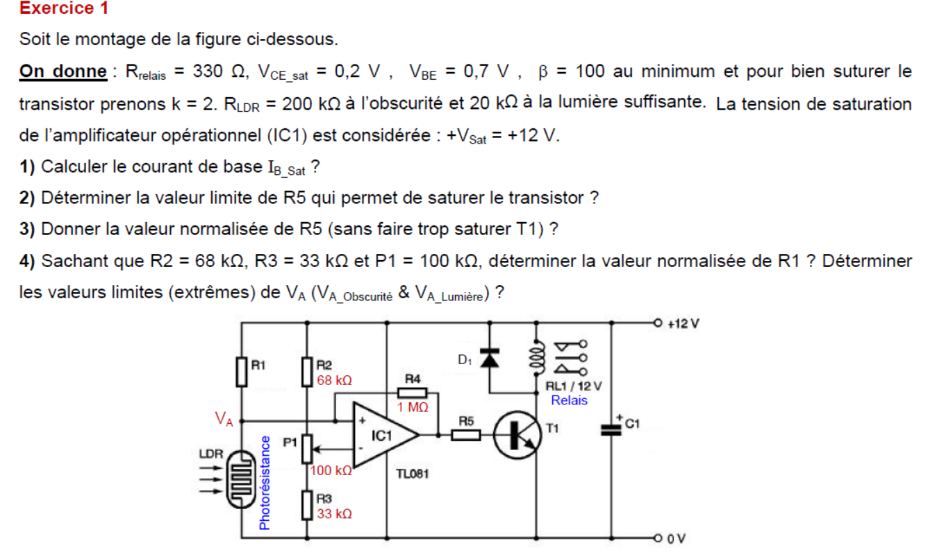

electronic home work (in french )

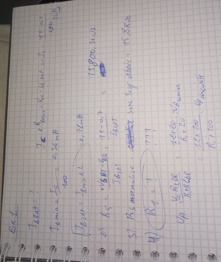

here i tried to solve it still couldn't figure last question

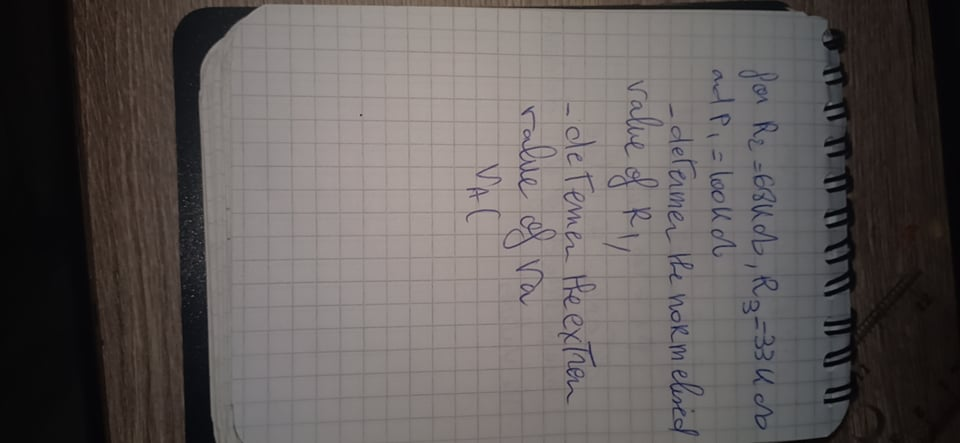

so, you'll have to translate the text in the image for the rest of the team to help you. Or, you can visit
technologie-électronique-enligne.fr
