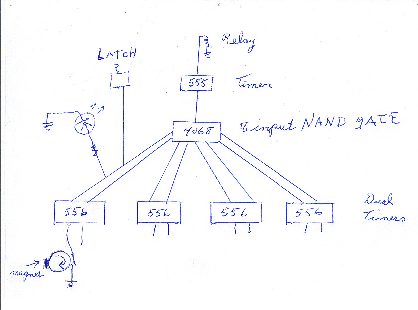

I built a 8 shaft monitor (missing pulse detector)
4 dual timers, 1 - 8 input Nand gate,
& a 555 timer that operates relay.
When all is running 8 diods are lit up.
If one of the 8 shafts slow down & stop, the one diods flickers
& go out, then the 555 timer opens up the relay
then every thing including the monitor goes dead.
What I would like is some kind of latch??
to tell me which shaft was the problem?

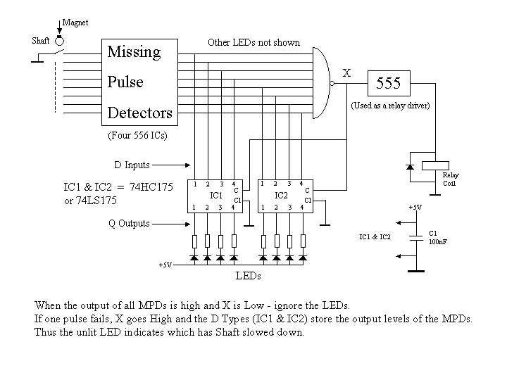

What you need is an 8 bit latch (or two 4 bit ones) so that when the LED "flickers" the latch stores the state of the 8 shafts so you can see which one failed.
Alternatively, you could use a parallel in parallel out shift register. Or make one up from D type Flip Flops.
Without knowing more detail of your circuit, that's all I can suggest. If you post the circuit, we will be able to help further.

Because my monitor goes dead when the relay opens,
I was thinking of a mechanical latch. (press to reset)
Is there such a thing??

I'm trying to attach a rough schematic.
Ben

Ben,
Attached is a suggestion.
I have assumed that the 555 is used as a relay driver rather than a timer. Is this true?
If you wish, you could connect a Reset button to the Cl pins of the D Types.
Len
