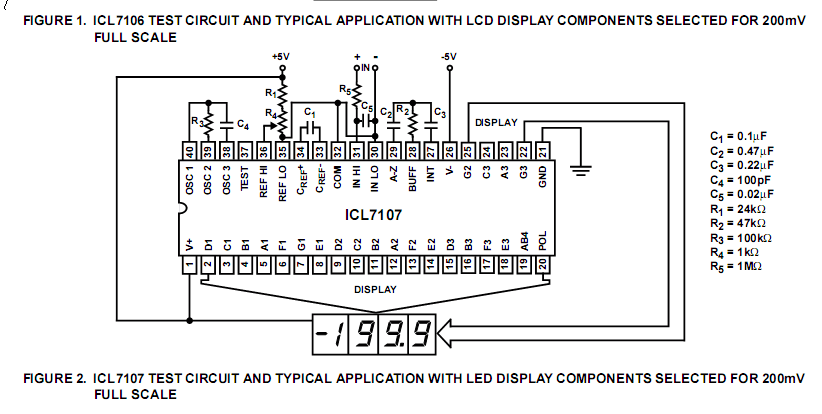

I am going to work on an electronic thermometer which detects ambient temperature and output to a seven segment display. Range is 0C-99C and it should be able to display upto one decimal point accuracy. eg. 12.5. I searched through net and found temperature sensor ic's readily available such as LM35,LM334 etc. I like to avoid bar graph display and LCD panel displays. Display should be very active during dark and I prefer seven segments. Any inputs are welcome. Also I prefer to avoid uC's but in my limited knowledge in electronics, I think the temperature sensing IC's can directly output voltage changes and the complicated thing is to add voltage to display functionality.
Use a digital voltmeter chip such as the ICL7107 with the LM35 as the input. Here's a link to a schematic you might be able to modify to suit your needs...
If you go the ICL7107 IC route you will be money and time ahead to go on eBay and buy the LED 3.5 digit digital voltmeter from Asia engineer for around $10 with free shipping. They use an improved version of the same ICL7107 circuit so all you need is to tweak the input voltage divider to work with your temp sensor.

I made several digital thermometers years ago. The first ones I built used the ICL 7107, These work good but the calibration process is time consuming. Later I switched to using a microcontroller and the DS1820 temp. sensor, no calibration required.
Actually, the LM35 gives a linear output, 100 mV / °C.
Just amplify that and throw to an ADC converter + Decoder + BCD driver.

1. DSxxxx to say a PIC with 3*7seg LED's [ he wants 7 segs as the display]
2. LM35 to a ICL 7106/7 adc ic with LED drivers. [this would be my choice]
3. LM35 with bar graph display.

jbeng, thanks for the information regarding ICL7107. Brevor, why you told that the calibration and finetuning is difficult for ICL7107.

I couldn't much understand the circuit posted by jbeng, but I think that it uses thermistors as sensors and you are suggesting an LM35 in place of that. Correct. Also I afraid, it's CPU temperature sensor mainly, and requires range settings for different environments. I want to avoid any post-implementation calibration and sensing range is 0C-99C.
Eric, do you think LM35 is capable of providing .1C accuracy. Then I'll stick on that. Anyway I want to avoid any uC here. How can I modify it for LM35?

Leno,
Did you look at the datasheet for the LM35?
Check the "Electrical Characteristics" on page 3, for "Accuracy" and "Nonlinearity". Even at a single temp, in the middle of its range it's only to 0.2C...1.0C at the extremes.
What are you doing that you need that kind of accuracy over that range? Even physically coupling a sensor to the CPU will result in variations of degrees C.

Eric, do you think LM35 is capable of providing .1C accuracy. Then I'll stick on that. LM35?
The accuracy of 0.1C is not possible, but a resolution of 0.1C is.
As you are measuring the room temperature, I would have thought that 0.5C 'accuracy' would be acceptable, but display the result to 0.1C.
The LM35 outputs 10mV/C so for 99.9C thats ~1Volt.
The ICL 7107 [LED driver version] has a base sensitivity of 200mV, so so by choosing the correct input resistors 100.0C should be possible.
Get the ICL7107 datasheet.
Not difficult just time consuming. (1-2 hours) It only matters if you are making many.
The ICL7107 is a good circuit, the units I built 20 years ago are still working today operating 24 hours a day 365 days a year.
How is calibrating that difficult? If you use the standard that water freezes at 0 C and boils at 100 C It should not take more than few minutes to fine tune one!
