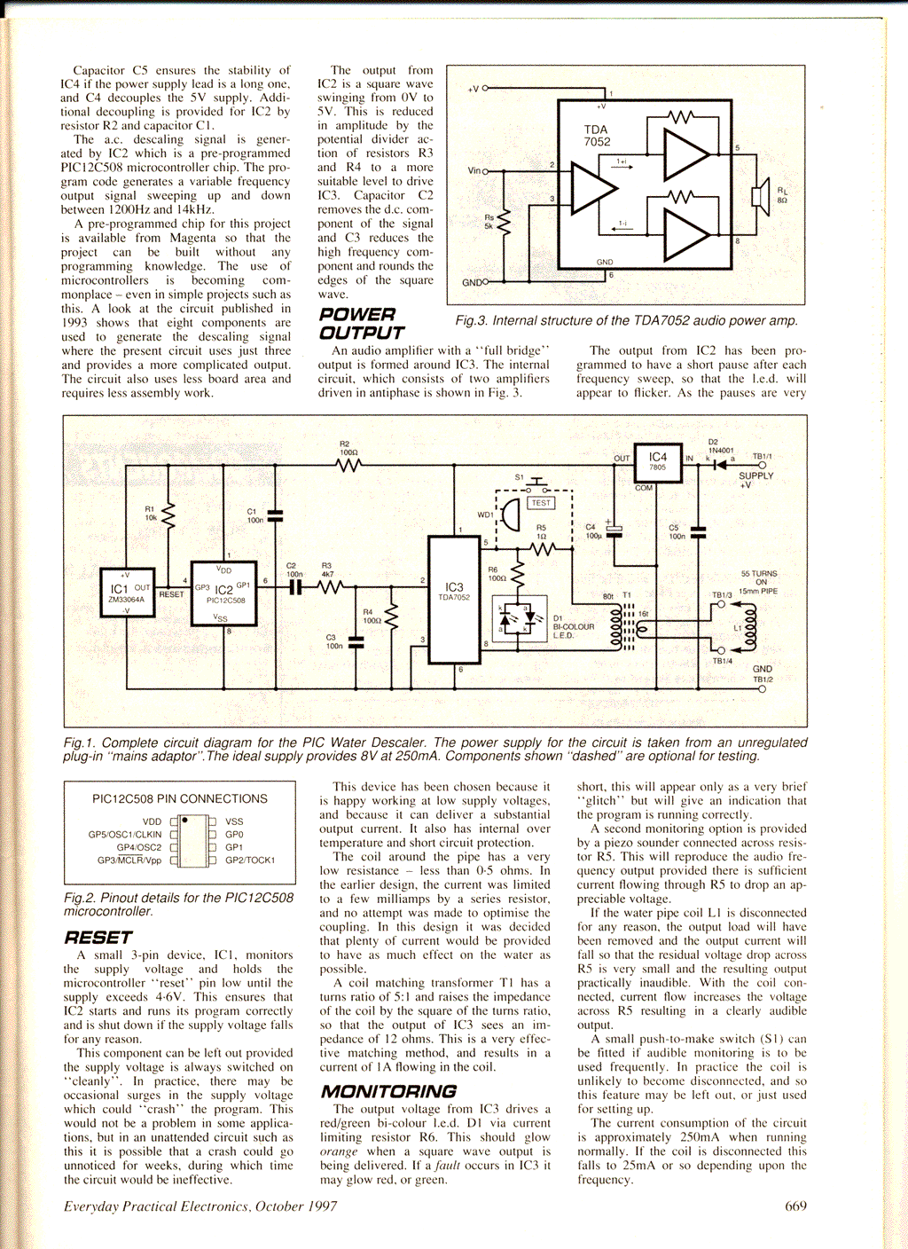

The UK magazine EPE have done a couple of them, at least one of which used a PIC. I presume you are aware that it's rather debatable if they work or not?.

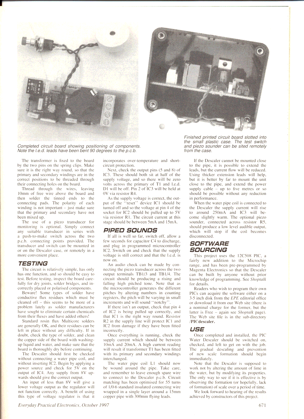

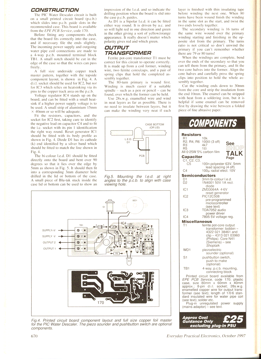

Ray,
I have scanned an article from EPE Magazine.
Hope it helps!
