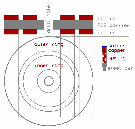

Here's my suggestion, easy to build and always proper and reliable function.
Make a double sided PCB (70µm copper layer for longer life, normally 35µm). Take one of those pins holding the bracelet of of a wrist watch. (Sorry, don't know the exact term)
It is a hollow steel bar with two small solid bars inside which are spring loaded.
Cut that part into two equal pieces using a dremel. Do it with caution because the spring will pop out eventually. Cut the spring in two halves too and shorten for minimim pressure. Insert the solid bar into 1/2 pipe followed by the adapted spring. Close the hole with a suitable piece of copper wire and solder the copper and the hollow steel bar together (it should be stainless steel, easy to solder) for mechanical strength. The stroke of the small steel bar is 0.5 to 0.7mm which will compensate for a slightly tumbling movement of the disc.
Use a second piece of PBC material and solder the contactors in place. Solder the connections on the rotating disc using through contacting. Make sure the contactor is absolutely smooth and ball shaped (ball shaped for self cleaning). Sharp edges will cut a groove in the PCB copper layer very quickly.
That way I've made measuring clips for for screw terminals to contact three terminals simultaneously.
For clarity take a look at the small Eagle sketch.
Hans
