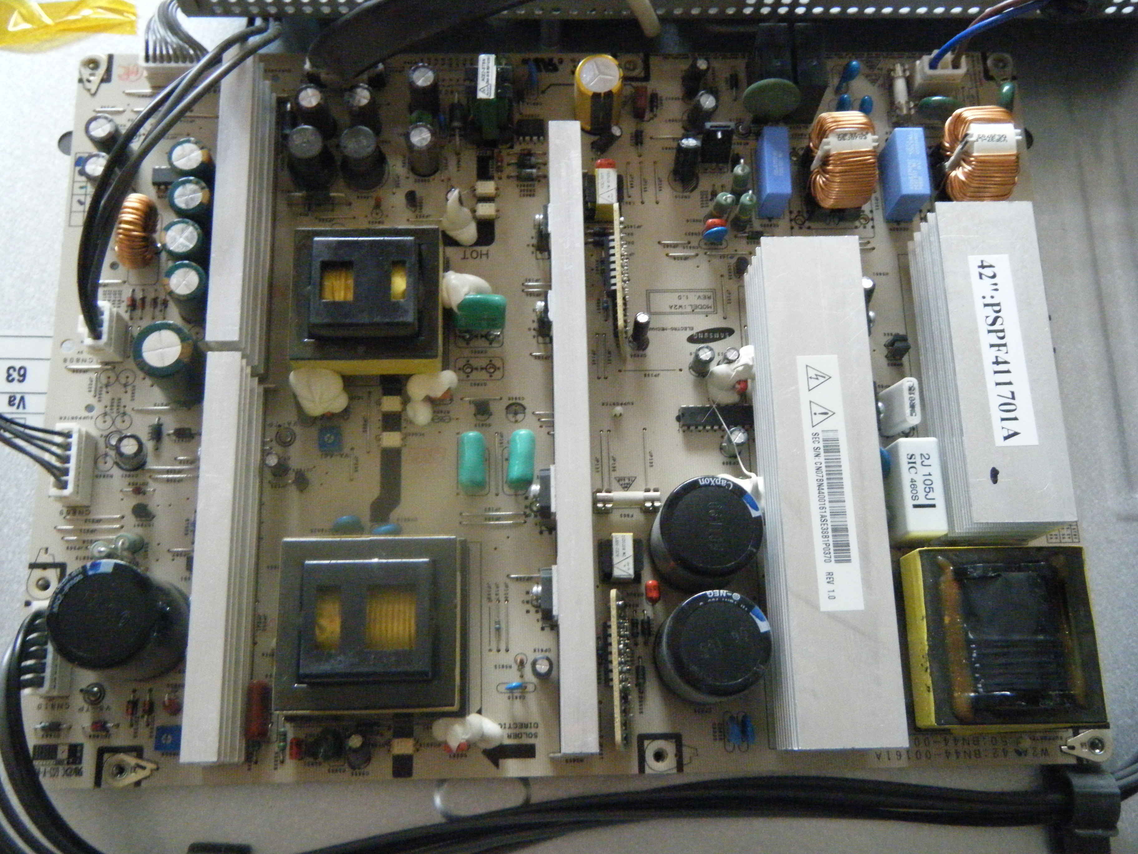

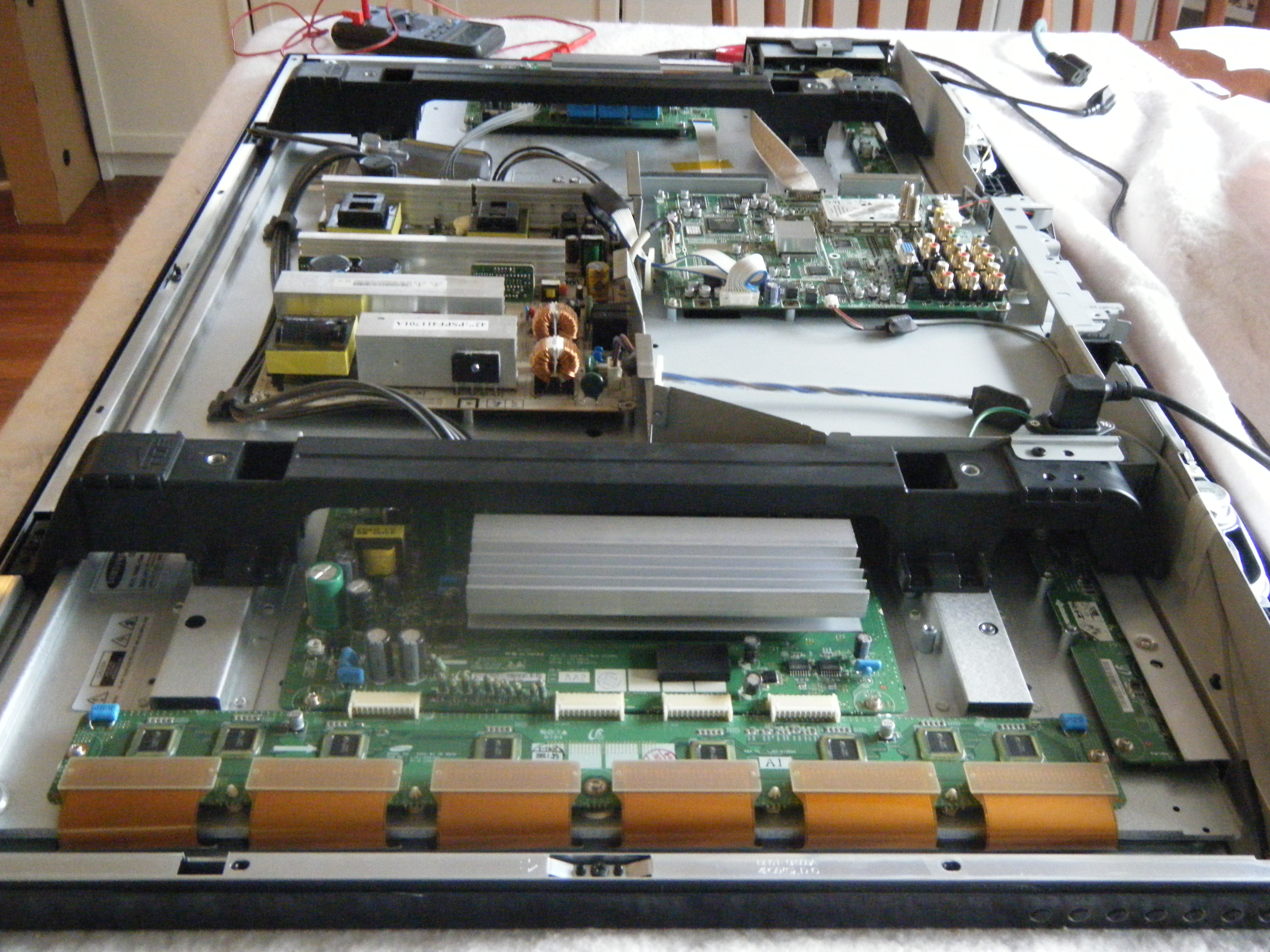

Our 42" Samsung plazzy stopped working today! First, it would turn on, warm up for a minute, then turn itself off!
Now the power supply has been clicking on and off!
Checked voltages once, 5V was 4.97v and 12 was 11.74.
I have already checked the caps-none look bad.
The supply steps up 120VAC to around 350 volts-that circuit is ok.
The second part of the supply has 2 different smps's, they BOTH don't output any voltage even though the main control board is trying to turn the supply on with the standby +5volts.
Any suggestions?

After a lot of searching on the web I have found the problem.
The problem is that a few mosfets are mounted together on a small heatsink-the 2nd from the left-and they typically run so hot over time they break down and eventually stop working.
Checked them and 3 of them read open.
Have bought replacements already but they will take about a week to get here.
I am thinking of putting a [quiet] fan in the TV to circulate the air more.
It's SO amazing that a small cheap part can cause something (worth thousands more) to break, and yet people just throw that stuff away!:rolleyes:

Got the parts today:D
they are:
2x 2200uf 25vcaps
2x FQPF13N50CF mosfets
2x FQPF9N50C mosfets
Will be replacing them soon!:)
Fixed!
The old transistors had just about burnt thier thermal pads to nothing!

I did not have any bad caps in my TV, but they were CapXon which are not the best brand.
The problem I had was some of the switching power transistors mounted on a big heatsink overheated, and failed.
When they failed, the TV control circuit(running on the 5V sub)just kept trying to turn the power supply on, without success.
Yeah mine started with clicking a little bit, but eventually coming back on, one day we tried to turn it on, and we got just a bunch of clicking.
I suggest that you check the switching transistors.
Take a look at the first picture in my first post of this thread.
That is the power supply, the transistors to check are on the 2nd heatsink from the left, they are
FQPF13N50CF mosfets, and
FQPF9N50C mosfets
