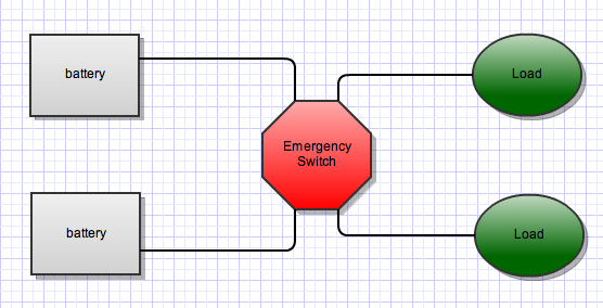

Does anyone know where I can find an emergency switch similar to the one below (design wise), that will allow me to disconnect two power sources if I press it?
The other alternative would be to have two separate emergency stop switches, and I would have to press both of them to disconnect power, however, I'm trying to simply things and have 1 switch that disconnect 2 sources. Refer to the image attached.
Emergency stop switch design example (I would prefer mine to be able to handle at least 25A)

Not really sure what you mean when you say you want to disconnect two power sources: do you mean two separate power sources connected to two separate loads?
In any case, you could use the classic "locked-out relay" circuit (described in this post). To disconnect n power sources, use an n pole relay (one with that many sets of contacts, one for each power source).

Yes there are two separate power sources connected to two separate loads.

This should work for your application:
The relay is any DPDT relay with the correct ratings. The coil voltage must be the same as at least one of your power sources (same voltage and DC or AC), and the contacts must be rated for your loads (25A, as you said).
The second source and load are completely isolated from the first source and load. Both will be disconnected together when the "off" ("stop") button is pressed.

Sorry, yep it's DC and yep it's for the other project of mine, however, I'm jumping the gun regarding the volts, as I'm hoping after I test my project it will work well with just 24v and not have to worry about using the full 36v setup.
All in all, I'm looking for a simple way of doing this, however, if it proves to be difficult to find one suited for my needs, I can revert back to plan B and use 2 individual E stop switches.

Well I assume after looking at your schematic my opening post was not clear or detailed enough, as my main point was, I would like a basic system that only includes 1 switch (E stop switch), and when that switch is pressed, it disconnects power to "both" circuits. When you manual lift that switch/button back up to it's original position, it unbreaks to the two circuits. It's like combining 2 E-stop switches into 1 which is a simpler overall system.
It's hard to see why something this basic isn't widely used, but that's what I'm after if there is one out there that can handle more than 10A, as that's mostly what I've ran into.
You could always use one of those big red switches connected to a relay; that would give you the 1-button operation you want and the current-handling capacity. (Again, relay coil must match supply voltage.)

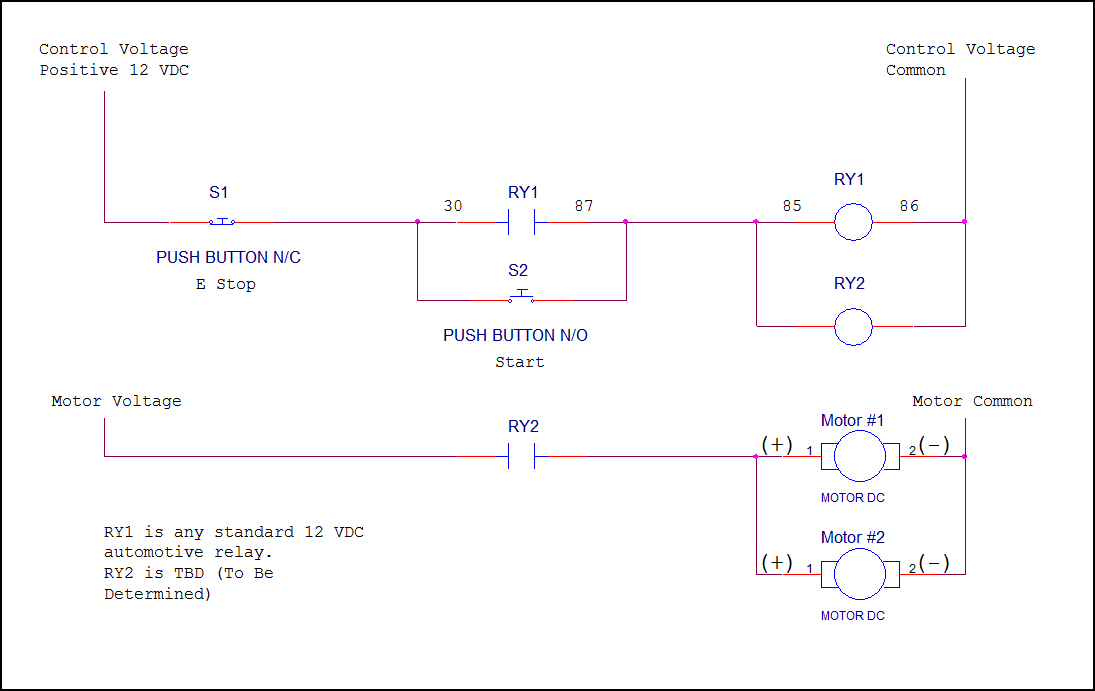

If you want an inexpensive means to switch high DC current then look towards automotive relays designed for switching high DC current. Also, read what I wrote about how E Stop switches are designed. They can have multiple contact poles, I mentioned how they were assembled.

You are as I recall using 3 batteries. I will make you a simple circuit using a start and stop (the stop can be your E Stop or any normally closed push button switch). We will do it based on 12 VDC for the control portion in an effort to make things cheap. Just make sure you go back and read as well as reread what has been posted. The idea here is for you to understand what the hell is going on with the circuit as in how it works. If not this evening I'll have something in the morning.
Ron
Attached is a version of what has been posted. It is generic because lacking motor data (exact motor data) it is difficult. RY1 is a standard automotive relay, RY2 would be slaved to RY1 and that is a high current relay (contactor) capable of the max current of both motors.
