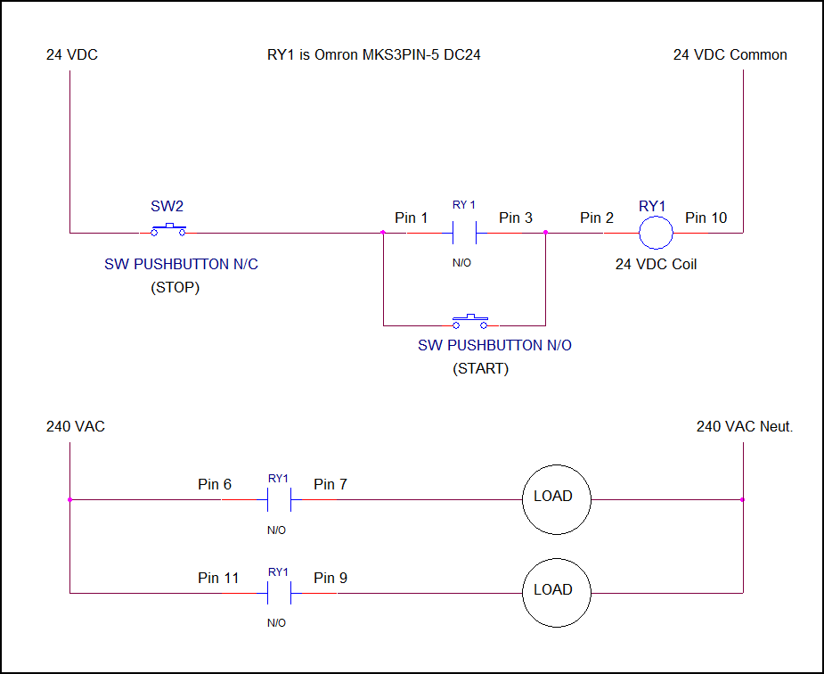

the voltage is 240VAC and at the moment i have used a toggle switch.I want to install the emergency switch for added safety.The emergency is going interrupt power to motors,light and heating elements in case of emergency.Got it?
Attached is another variation of the circuit that was already posted. Additional normally closed switches could be placed in series for additional E stops with the first switch. In this example the control voltage is 24 VDC and the switched voltage is 240 VAC. The data sheet for the relay RY1 can be found here as a refrence. There are a dozen ways this can be modified or adapted to suit your needs. If for example you want all 220 VAC control then use a 220 VAC relay coil.
The circuit I posted will do that. All you need to do is hit the momentary-contact OFF switch (normally-closed), and the whole thing will shut down immediately. If the power goes out and is restored, it will still be de-energized until someone hits the ON switch.
Ron's circuit is the same thing, but with the relay coil operated with low voltage (from a transformer) instead of line voltage. Either one will work fine.
E-stop switches are ALWAYS to be normally closed -- open to stop. That way, a defective (usually open) circuit doesn't allow the circuit to run and neither will it not work to stop the circuit as a normally open switch in an open circuit would.
