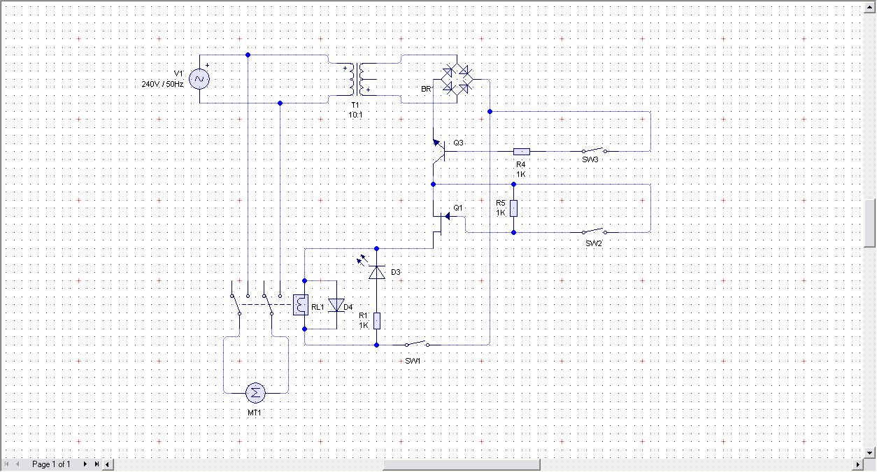

emf ?
You are worried about "stuff" generated from the motor passing through the transformer? I wouldn't worry about it.
BTW, BEMF stays inside the motor for the most part, especially if you are applying a voltage to the motor terminals. If you disconnected the mains and then rotated the motor, the motor would act as a generator and travel through the transformer.
Ok, I got it. This low voltage control stuff has my head spinnin. Thanks
killivolt
Killivolt:
I wanted to know if the back emf from the AC motor in parallel to mains. Would somehow effect the rectifying circuit thru the transformer causing problems to the control circuit ?
Thank you, kv
Indeed it could killivolt, along with other obvious problems, good question! According to the schematic, the single phase AC motor should have a RC snubber in parallel with the motor to suppress any transients during the relay switching of the inductive motor load. Also there should be a zero crossing detector within the control circuit to allow relay switching to occur only when the AC voltage across the motor is passing through 0 volts.

Hi, Killivolt, that is quite a control circuit for switching a simple motor.
Probably there are situations where this is type of control is necessary, but generally speaking there is not a problem with Back EMF. In the Household motors switch in and out all the time (refridgerator, freezers, washing machines, dishwashers, Garage doors,etc.) all these produce inductive kicks that reflect into the household circuits. Clocks , TV's etc all use Bridge rectifiers and do not get damaged.
When our washing machine switches on the lights flicker. This is caused by the voltage going low due to the sudden current drain. This type of "disturbance" or "transient" produces quite a voltage spike but it never seems to do any harm to my clocks, computer ,radio or TV on the same circuit.
Zero Crossover detection and Prediction/Compensation cctry may well be desirable in applications where there is a continuous switching eg in telephony/communication type ccts , but I think it is "overkill" in the cct you present.
Just my Opinion though
Cheers
RH

The Back EMF isn't something that "comes out of the motor". Think more of it like something that fights the AC voltage source so massive amounts of current don't flow through the motor.
But switching inductive loads will produce voltage spikes and those could travel through the transformer. WHat happens is that if you have current flowing through an inductor and you suddenly cut it off, the inductor will still try to keep the current flowing (or at least changing very gradually). It does this by increase the voltage across the inductor (similar to increasing the voltage across a resistor to get more current flowing through it). This is where the voltage spike comes from.
For a unidirectional DC motor you can put a diode across the motor to let the current have a path to flow between the motor terminals (letting the current reduce gradually and getting rid of the voltage spike). For a bidirectional motor circuit where current flows both ways, obviously a simple diode won't work since it will short-circuit in one direction. So you put diodes across the MOSFETs in an H-bridge to try and do the same thing. In an AC motor, what you can do is put a resistor and capacitor in series across the motor terminals to help absorb the inductive spike. (YOu should actually put it across the transformer since that is the thing you are trying to protect. Putting it right at the motor doesn't shield the transformer from the inductive kick caused by the inductance in the wires of the line.).
So yeah, I agree with the others. I didn't notice the switches by your motor. BUt those can cause spikes that will go through your transformer. Not the BEMF though.

Hello, this is my first post. No, cemf from the motor wont affect your circuitry enough for you to notice, I suppose in theory its possible, but like I said, you most likely won't notice it. A quick statement though, why all the circuitry? This all could be accompished with a simple toggle switch (rated for 240). Theres no real "motor control" going on here-other than on/off (which I suppose is technically accurate-but motor control typically refers to alot more than on off). The little led is nice though..and it is kind of fun to tinker, but like I said, a simple toggle switch will suffice. If you really want to play around with motor control, use a small cheap P.M. (permanent magnet) D.c. motor and use your triggering circuitry to drive an scr (silicon controlled rectifier) to vary the speed of the motor-more complicated but alot more fun-especially when you get it to run right.
There some thing i don't think your getting here. A AC motor switches at the 50khz to 60khz of your supply. So it can't do any thing like a spike on a DC motor the the only thing that happens with a AC motor is it pulls a lot of amps when started. which can strain your supply till the motor starts. Thats why most AC motor have starting capacitors to boost supply voltage going to the motor and give it a current boost.And a DC motor spike because it gos from using power to making power which is like putting two battery's in series. You turn off a AC motor only thing that going to happen is you'll have more current.
