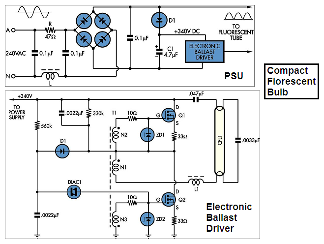

energy saver light bulb schematic
I think the energy saving part is in the construction of the bulb?
Incandescent bulb? Florescent tube? Compact florescent bulb?
They are all very different.
They make an incandescent bulb and florescent tube "energy-saving" by simply making use less power. A 100W incandescent becomes 85W. A 40W florescent tube becomes 34W.
Your vision responds logarithmically to brightness so you don't notice that "energy-saving" lights are dimmer.
A compact florescent bulb is much more efficient than an incandescent and uses about 25% of the power for the same brightness. Manufacturers say they outlast an incandescent bulb about 10 times.
Here's the schematic of a 240VAC compact florescent bulb that probably isn't made by GE:
