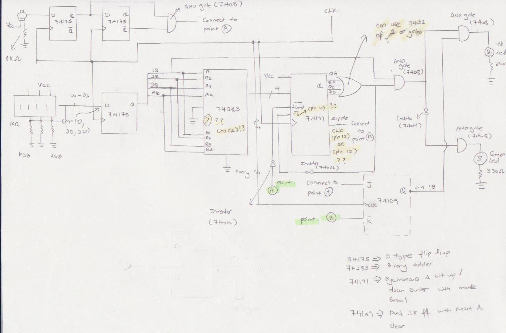

here's the layout of the ic and anything i can amend from there?
Looking over your circuit I have the following observations.
Assuming the drawing is correct, its a very complex way of trying to flash the LED's in the way you describe.
What purpose is the 74175, connected to the bit switch, serving?
The Ax/Bx inputs of the 74283 adder are linked together, so its always adding the same pair of numbers.
Its just left shifting the bit switch value, by one.?
Where is the'clk' signal coming from?
You are clocking the 74191 [bottom one] with 'A' to give a 15 divide by signal 'B' [you say, ripple clk???], which are used as 'J' and 'K' inputs to the 74109.
Can you let us know what the projects for and whats it purpose.?
Eric

Yes, please. Digital circuits are based upon logic, not magic.
The 74175 was given in the project as starting point.
Yes, so that the led will keep counting on.
I'm confused with the clk signal.Where should i clk it?Can advise me?
It act as a alarm alert system.

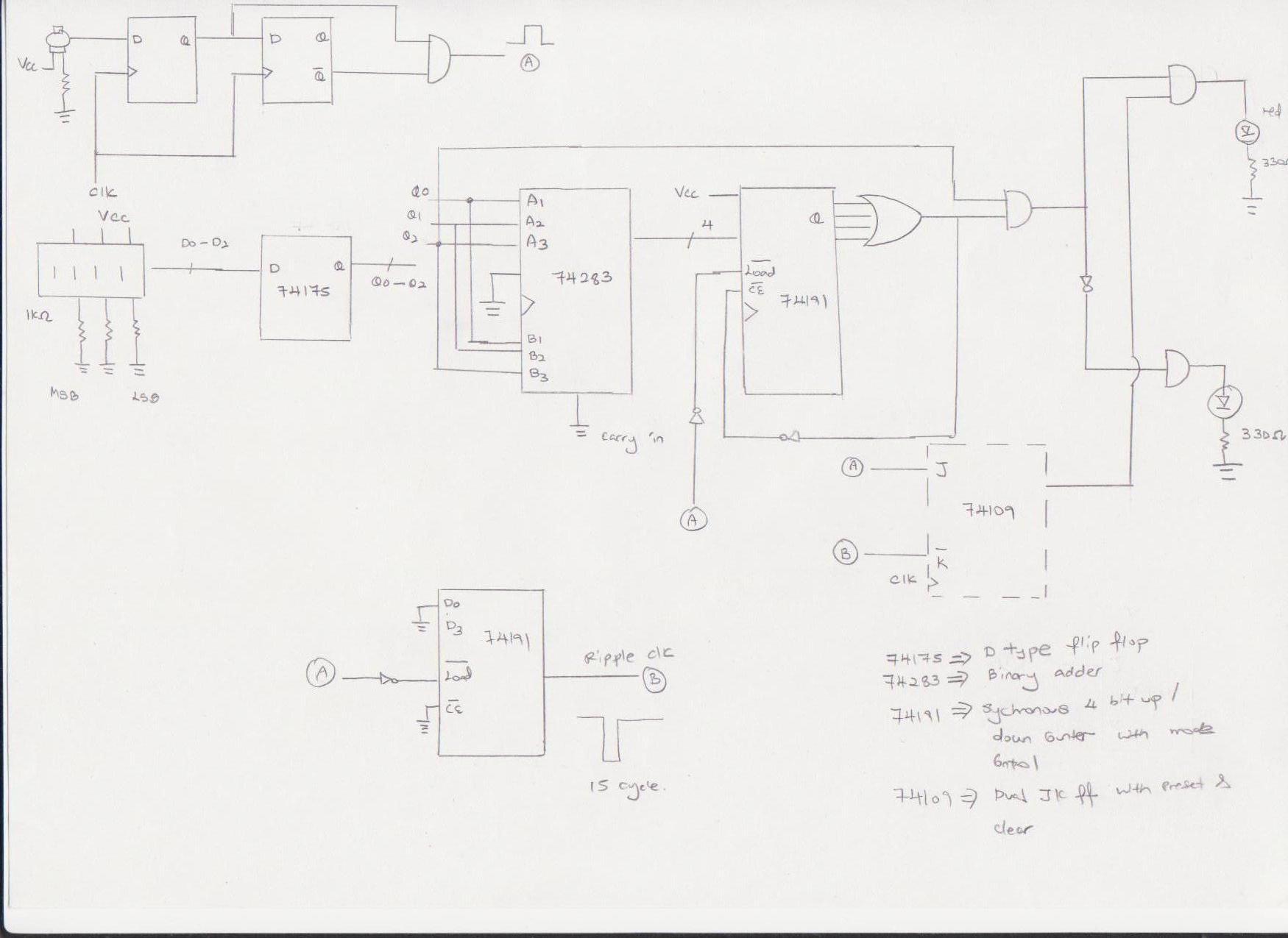

Hi Eric,
I have redone again. Can you advise me if i need to amend any part immediately? Thanks.
For IC 74175 and 74109, there have got CLR function pin.
I do not want to clear. How should i connect in such a way to disable clear?
hi shermaine,
On the 74175, pin 1 CLR, connect it to +5V thru a 2K2 resistor.
74109, do you mean 74191?
If Yes, which pin number do you mean, cannot see a CLR on the ic diagram?
If you mean pin 4, 'Enable' connect it to 0V, to enable the counter.
