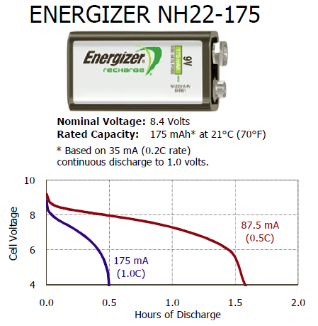

A rechargeable 9V battery voltage drops like a rock when loaded because it is small and its capacity is very low.
