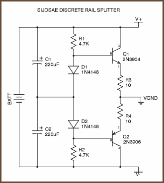

Why are there transistors with diodes in the power supply circuit?

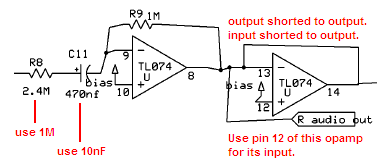

here is the source of the power supply and wondering about the input buffer that you suggested. using pin 12??
could be I misinterpted your suggestion or ?
need to take a second look at the 4017 circuit. orginally had two 4017's driving 2-10 x 10 displays.

PS you don't need a rail splitter since you're using a dual rail supply. So nertz the transistors in the powersupply.

Will get rid of the transistors and go with the two regulators.

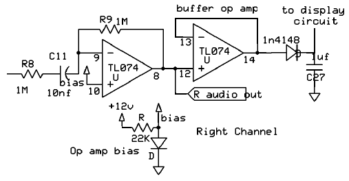

audioguru mentioned something about the op amp buffer. I searched for a buffer circuit and found the onepictured. The one in my circuit is to isolate the display noise from the audio.

Each EQ frequency band needs to have its own peak detector. The multiplexing feeds the output of each peak detector to the LM3916 in sequence.
Your buffer opamp was upside down and backwards. It is supposed to have a high input impedance and a low output impedance like this follower opamp:

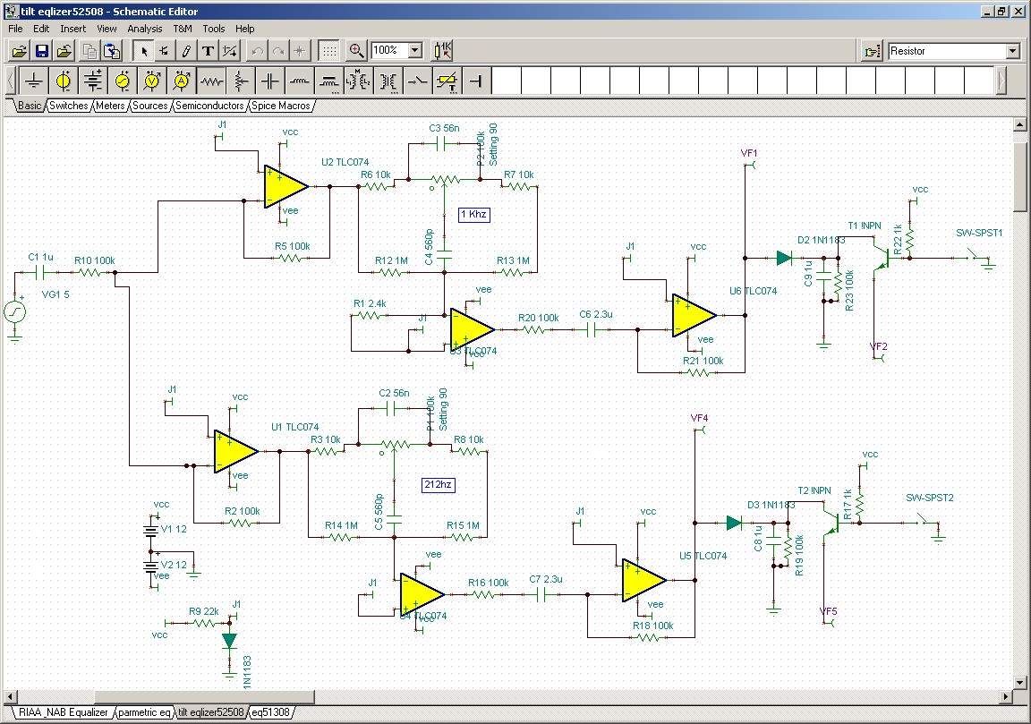

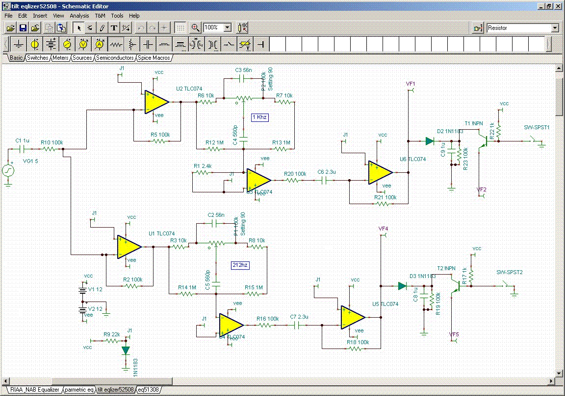

Really confussing filters
While looking for another filter circuit I ran across this one BUT the center frequencies are way different but the circuits are almost the same?
can't believe the 2.4K resistor changes the center frequency?

The filters are for a one octave bandwidth. How are you going to decrease the Q so that each one covers two octaves?
will be 5 filters per channel
going to build 5 filters with different cap/ resistor combos.
hope thats what you are asking.
No, I am asking if you will modify the values in the filters so that they have a bandwidth of two octaves. Because the circuit has values selected for a total of 10 filters so that each filter has a bandwidth of only 1 octave. The Q of each filter must be reduced in order to increase their bandwidth.
I would give you the formula if I had it but I have never seen this filter before.
