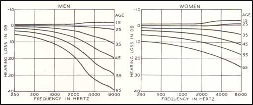

Here are graphs showing normal hearing loss with age:

I'm sure it does, but that does not mean that an equalizer with a gazillion 10-Hz adjustment bands is necessary to correct things. For example, if your test showed a steady decrease in sensitivity of 3 dB per octave for everything above 500 Hz, it can be corrected with one opamp and a few R's and C's.
An equalizer with one adjustment per octave would have 11 adjustments. Is this what you have in mind to start with?
Edit: When you said your test shows 10 Hz ranges, does that mean each range is 10 Hz wide (what I responded to ), or that there were a total of 10 ranges across the 20-20,000 Hz spectrum. That would be approx. 1 per octave.

My "normal for my age" high frequency hearing loss is almost a straight diagonal line with a flat part at very high frequencies. It needs double the amount of boost from a tone controls circuit. I think the audiologist adjusted the level of each octave from 250Hz to 16kHz (7 frequency bands) on an audio equalizer. The hearing aids most sensitive setting has the lows and highs reduced.
It sound like we both have the same type hearing aids. Not sure mine is made by Phonak in Switzerland, model Audeo V. I was going in once a month for adjustments. After that I went in every 3 months. My last free appointment is in 5 months. I have 3 programs. If I click the button on 1 hearing aid they both switch to the next program. #1 is for every day talking and activities. If there is lots of noise like a restaurant or driving in the car I can switch to program #2. Program #3 is extra sensitive for TV or being able to hear birds better or the night time sounds like crickets, frogs, bugs. If someone coughs or sneezes it blasts my ear drums out in all 3 programs. I had sensitivity increased and had noise compression set for loud sounds there seems to be a limit to how well that works. It is working very well so far but I can still not hear things I once could hear like an old type wind up clock ticking in another room at the far end of the house or the kitchen water faucet dripping while I am in bed far away or bugs flying around a light bulb after dark or a house fly or misquote unless it is right in my ear. Maybe I am expecting too much. Your right there is no way I can build all those hearing aid options into a small hearing aid amplifier circuit I will probably need a wheel barrel to haul it around. If i put on good ear phones that cover my ears and listen to music I hear sounds I have not heard in 50 years. Good ear phones let me hear things the hearing aids do not hear. I can listen to music and watch TV with no equalizer & no Hz adjustments and hear better than hear aids. This makes me wonder if my tiny IC amp with good ear phones will work as good or better than hearing aids. Most of my hearing problems is from allergies & ear infections all my life. I started having hearing loose when I was about 19 yrs old.
This is my hearing test. Zero is right ear, square is left ear.
