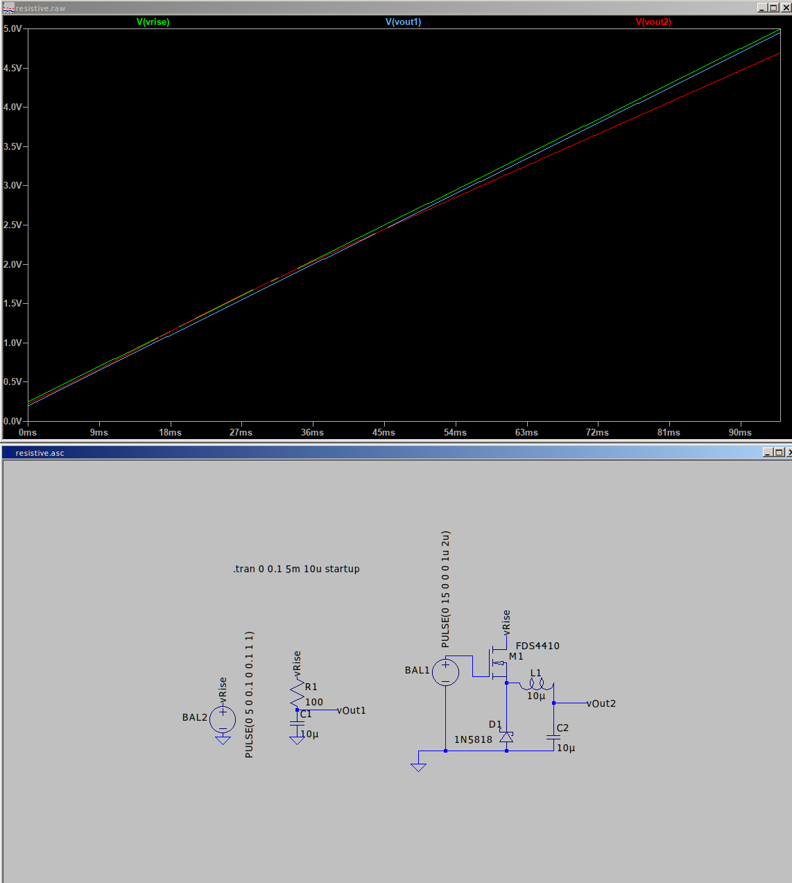

Assume the input and output voltages are known, that the buck is operating in CCM mode.
Is there an equation which can use the duty to represent a resistance?
