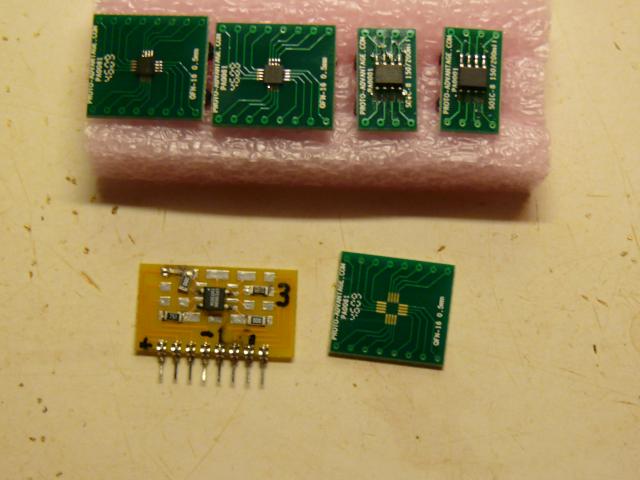

In that case, you can also use these guys: http://www.proto-advantage.com/store/
If you have a digi-key p/n, they will provide the part installed on the adapter.
Digikey also sells these: http://www.capitaladvanced.com/6000ser.htm

I can post a pic of a board I did using the SIP thingy along with a Proto-advantage part if you want.
Proto-advantage does not put an orientation mark on their adapters.
When the pitch is fine, you pretty much need the solder mask which many of the adapters provide.
At a minimum, tack a few corners. Then turn the part UPSIDE DOWN. Run the iron along the pins with the part upside down.
Flux helps, but is not essential. The VERY FIRST SMD part I replaced was a processor in a car radio. That was painless with the upside/down trick.
For other SMD parts, you can use a tiny drop of superglue applied with a toothpick to the body.http://www.capitaladvanced.com/6000ser.htm

The first pic is some of the stuff I had Proto-Advantage do for me. On the bottom row, there is part of an unassembled adapter. I bought a few to practice with.
It was tough getting and posting the pic of the SIP board. First time using Linux. Note the 0 ohm resistors. If you really look close, the component in the upper left corner is a SMT LED.
The glue is the Cyanoacrylic type. I'd use the thick variety. It is a gel or liquid that dries without air. https://www.google.com/url?sa=t&rct...W_TL94uV7apAcBzPqNxRrxw&bvm=bv.49478099,d.dmg All it does, is hold the component in place. It bonds instantly, but may give off some nasty fumes. You glue the body. Not the pads. The key is apply pressure while curing and apply with a toothpick.
