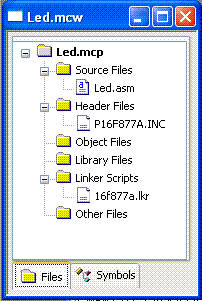

I am new to PIC programming in assembly
i am learning from Nigel Goodwin's tutorials but i have PIC 16F877A
I have some questions
Q NO:1- Why these errors???
Q NO:2- It is necessary to add "P16F877A.INC" file in ur "***.mcp" window under the header button???
Q NO:3- It is necessary to add "16f877a.lkr" file in ur "***.mcp" window under the linker scripts button??
Q NO:4- Is the both files("P16F877A.INC"..."16f877a.lkr") should be in our working directory???

add an endc command after cblock also indent the last END statement.
You also don't need the (Q3) Linker Script or (Q2) Include file in the screenshot, you alread have them defined in the program.
; VARIABLE STORAGE
        cblock        0x20                ;Start of gernal purpose Register
        endc
