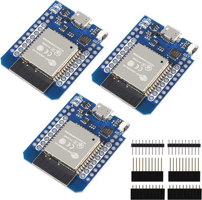

Have a look for "ESP32 MINI D1 WROOM-32" - look for the version with two rows of holes either side, there is a smaller ESP2866 D1.
That's got a reasonable amount of I/O and appears to only exist in one footprint.
