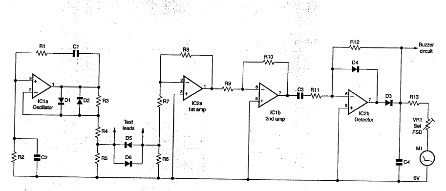

You can probably get away with just doubling the value of R13, as long as you can adjust for full scale with the pot.

As for the meter, simply stick a shunt in parallel with the meter, equal to it's internal resistance (it's how you make a 100uA meter out of a 50uA one).
Thanks Nigel. So for the shunt, just measure the resistance of the meter and then add a equivalant resistor of the measured value in parallel to the meter?
Yes, apart from the meter should have it's resistance stamped on it somewhere anyway.
If you're measuring the resistance, be careful of how much current you feed through it.
Here's everything you need to kow about shunts and multipliers:

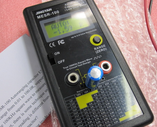

DIY one I made was flakey, bought one off of Ebay MESR-100. Complete piece of rubbish. They do have a newer model, maybe better.
All the time and money and I should have just purchased the Blue Esr. What's your impression of it, accurate, easy to use?. Would you recommend, and trust it.
