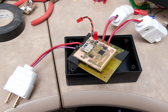

I started this up a while ago, but I got distracted. I used to have red lights with blinking white around my garage, but with LED bulbs now I can't get that. I just made a 4 channel controller to control 4 strings of lights. The controller is complete and controls the four strings of lights, 2 white, and 2 red. I'm going to remake the control board part, since it's too complex now. I originally designed it with SD card control, but I found I can put in very complex and long patterns with very little memory and my idea of being able to change the patterns by just writing a new file to the SD card and plugging it in, seems nice, but based on the amount of times I'll change patterns it's a waste of time. It also turns everything on at dusk with a light sensor.
It's no crazy light show, but it's a start and my first try at doing mains control and dimming.
Only two of the plugs are connected in the picture, which was taken during original testing a few months ago.
I may do more before Christmas rolls around.

Very neat and professional looking work DirtyLude, nice work!

Okay, I finally finished off one of these things and need to assemble the other. I took a video of it doing a test pattern on my garage lights. Dims and flashes and patterns.
Here's the Eagle files for the controller and the power board that has the TRIACs and other high voltage stuff on it. The power board has 4 plugs on it, but you can stack 2 power boards together with one control board to control 8 lights in total.
https://www.higginstribe.com/uc/lpc1xxx/xmas-dimmer/light-control-lpc1313.zip
Here's the code: It's mostly just setup and switches to step through all the lights processing. It's all interrupt driven. The uC is an LPC1313 (it says LPC1114 on the schematics, but I used a 1313).

      if( light[current_light].on_point == timer_int_counter) //turn on signal
        switch( current_light)
           case 0:
             LPC_GPIO1->DATA |= LIGHT0;
             break;
           case 1:
             LPC_GPIO1->DATA |= LIGHT1;
             break;
           case 2:
             LPC_GPIO1->DATA |= LIGHT2;
             break;
           case 3:
             LPC_GPIO1->DATA |= LIGHT3;
             break;
           case 4:
             LPC_GPIO1->DATA |= LIGHT4;
             break;
           case 5:
             LPC_GPIO1->DATA |= LIGHT5;
             break;
           case 6:
             LPC_GPIO1->DATA |= LIGHT6;
             break;
           case 7:
             LPC_GPIO1->DATA |= LIGHT7;
             break;
      if( light[current_light].on_point + 3 == timer_int_counter) //turn off signal
           case 0:
             LPC_GPIO1->DATA &= ~(LIGHT0);
             break;
           case 1:
             LPC_GPIO1->DATA &= ~(LIGHT1);
             break;
           case 2:
             LPC_GPIO1->DATA &= ~(LIGHT2);
             break;
           case 3:
             LPC_GPIO1->DATA &= ~(LIGHT3);
             break;
           case 4:
             LPC_GPIO1->DATA &= ~(LIGHT4);
             break;
           case 5:
             LPC_GPIO1->DATA &= ~(LIGHT5);
             break;
           case 6:
             LPC_GPIO1->DATA &= ~(LIGHT6);
             break;
           case 7:
             LPC_GPIO1->DATA &= ~(LIGHT7);
             break;
      current_light++;
    LPC_TMR16B0->IR = 1;			// clear interrupt flag
  return;
Kudos! As usual, that is really neat work and looks great.
Thanks Edeca. It's nice to have completed something that actually does something noticeable as my Wife thinks I pretty much fiddle with stuff just to make toys.
