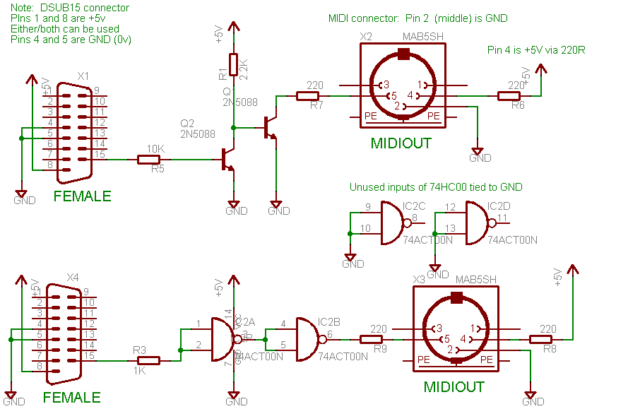

The "Evolution MK-7" midi keyboard is equipped with a MIDI OUT Connector, for connecting directly to PC sound card game port.
I want to connect the keyboard to input MIDI-IN a musical instrument equipped with DIN connector.
I wish assistance consisting in:
-What are the terminals used the connector's MK-7, for connecting to the computer, which is their significance,
-Schematic diagram of a device that allows interconnection mentioned, placed between the output of MK-7 and DIN input from musical instrument.
Thank you.

Its intersting that the keyboard has a specific gameport connector. Most keyboards have the standard midi connector (din) which means one requires a gameport midi adapter. So ultimately all you have to do is make something that does the opposite :D
Gameport signals are TTL 5v. Midi is based on a 20mA current loop (I tihnk..) so there will be some buffering needed, either bipolar transistors, or logic.
For MIDI- > TTL one usually requires an optoisolator to convert the 20mA current loop into 0-5v logic level. ..but I assume you just want to convert the gameport to 'midi out'?
http://pinouts.ru/images/pc2midicable.gif
http://www.cryogenius.com/hardware/sbmidi/intrfaca.gif
Note: the above schematics are for connecting to a PC's game port. You want to connect to the devices thats pluging into this. So, swap pins 12 and 15 on the game port connector in the schematics. (so that Tx -> Rx, and Rx-> Tx). Midi OUT form the DB15 (MALE) gameport connector will be on pin 12. Pin 15 is for providing the keyboard with data. Also, you'll need a female DB15 connector....or just solder wires to the gameports pins if you can get inside the connector hood.

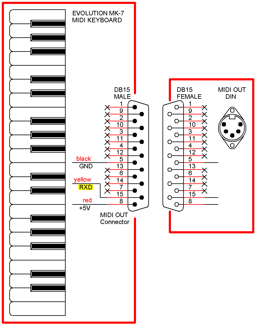

I looked inside the instrument, I saw that only 3 of the connector terminals are basically used:
8 (red wire),
5 (black wire),
15 (yellow wire).
The keyboard is midi out only, so ony uses two pins - the third powers the keyboard with 5V from the game port - so you would have to provide a 5V supply for it.
8 (red wire),
5 (black wire),
15 (yellow wire).
As I said in my first reply, assuming the keyboard is powered with its own power supply (which it probably is) you can use the three lines from the game port connector to convert it to standard MIDI out with a small driver circuit. Using either transistors, or some simple TTL logic. If the keyboard has no power input, and it uses the power from the game port (unlikely) then you'll need to power it externally.
The 5v will power your driver circuit, and pin '15' (which is MIDI OUT from your keyboard) is the signal.
I have attached a small schematic which should do what you require. You can either use a female DB15 connector, or remove the connector form the cable from the keyboard and solder it directly.
Blueteeth
