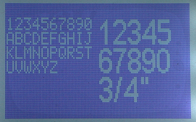

UPDATE
After a little playing with using the stack, I got it to work essentially as Mike wrote it. (He didn't know that I didn't put XY data to SetLCD_X and SetLCD_Y in w. Those data needed to be moved to their respective registers.) Thank you, again.
With Big_Str, I had to incorporate a counter so the next X-position for a string could be calculated. That worked OK, and in the example attached hereto, you will note that not all of the big characters are the same width, but spacing is only one column, except for the slash and inch, for which it is intended to be different (e.g., check #4 vs #3).
General impression: I can see that using the stack can be quite useful, but I need a lot more experience with it. I may just go back to the older method. The PutStr macro is exceptionally helpful. It may not save steps, but it certainly makes that part of the code more readable.
Specific questions:
1) Is there any way to read the current X-position? That is, rather than calculating it, it would be nice just to read it.
2) Note that for slash and inch characters, I gave them consecutive non-ascii numbers so my table would stay small. Obviously, I could add them at the proper ascii positions and fill the table with nulls. For this demo, I simply built up the 3/4" string in pieces. Using the macro as shown, is there a way to include the information with something like: {'3' 0x0b '4' 0x0a} in the single space for "text"?
