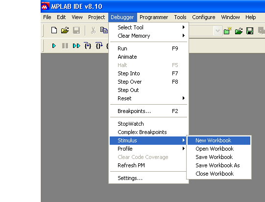

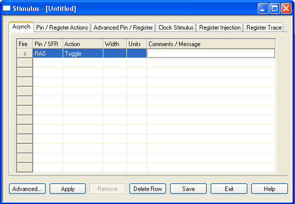

I tried this but since I have very little experience with MPSIM I wasn't able to figure out how to build a stimulus file so it just sat there when it reached the first statement checking to see if a pin was high or low. I need to figure out how to do this but it will have to wait for now.
It is quite simple to use. First you select the SIM as your debugger. Then you go here:
stim-png.32085
Then you simply select the port bit you wish to toggle and how it shall toggle:
stimulus-png.32087
And click the "fire" button to stim the pin. You don't have to save it as a file if you don't want to. Simply minimize the stim window and continue debugging.
