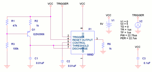

If you take a 555 timer and inject a constant current source into its its threshold and discharge pins, you will see linear ramp appear on that pin. The straightness of the ramp depends on the flatness of the current source's I-V characteristic.
I used the attached system in a ramp ADC running close to 44kHz. The ramp will appear on the collector of Q1. The trigger can be the output of another 555 if you want. I'd also adjust C1 and C2 to get right time constant.
The main limit is that it will only drive high-impedance loads. Our load was about 100kOhms. When we lowered it below 50k, the ramp seemed to destabilize.

DigiTan, he has already made it clear that his goal is not to generate a linear ramp per se. His goal is to linearize the exponential discharge of a capacitor.

Thanks for sharing it, but the circuit u posted is for generating a linear ramp from a constant source. My question was to change an exponential decay voltage to a linear increasing voltage. The dischrage is in exponential, so in order to linearized it, i have to have a circuit that have a -ln function. PIC would be my choice, but logarithmic amp could also do. Its juz that it might b in terms of analog, where u cant program to a certain logarithmic function like PIC does.. Thats what im thinking :(
