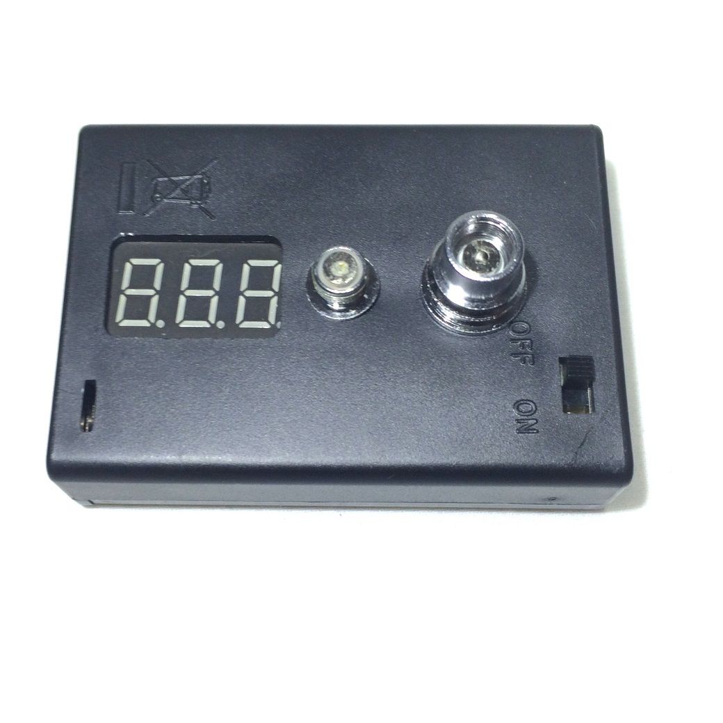

I'm considering buying a cheap four pin micro ohm meter (**broken link removed**), just because it's cheap.
However, I cannot find any reliable sources on the net that states anything about the quality of those. I do not care if it is barebone, as long as the readings are correct.
Any of you have any epxperience with those devices, and hopefully can say if buying one is a waste of time?
I bought one of the one's listed as per the one photo. I could measure low ohm resistors by touch the center pin and the outside. It seemed impractible to me so I opened the case and rebuilt it in another box and the results were great as shown. The resistor is is measuring is a 2.7 ohm resitor.

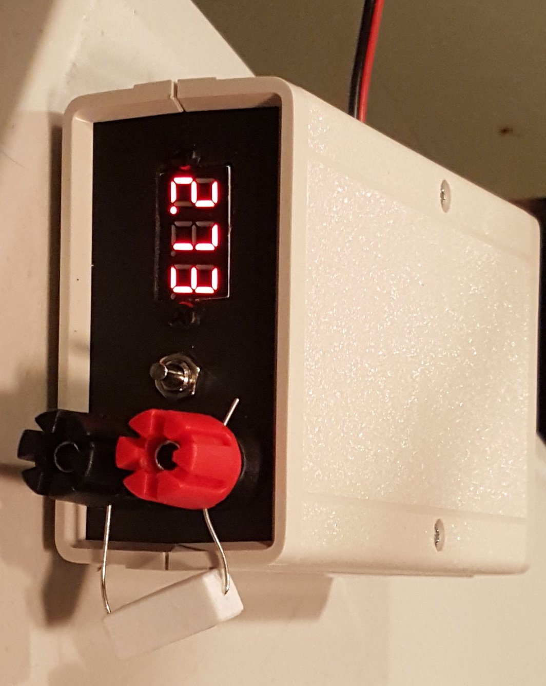

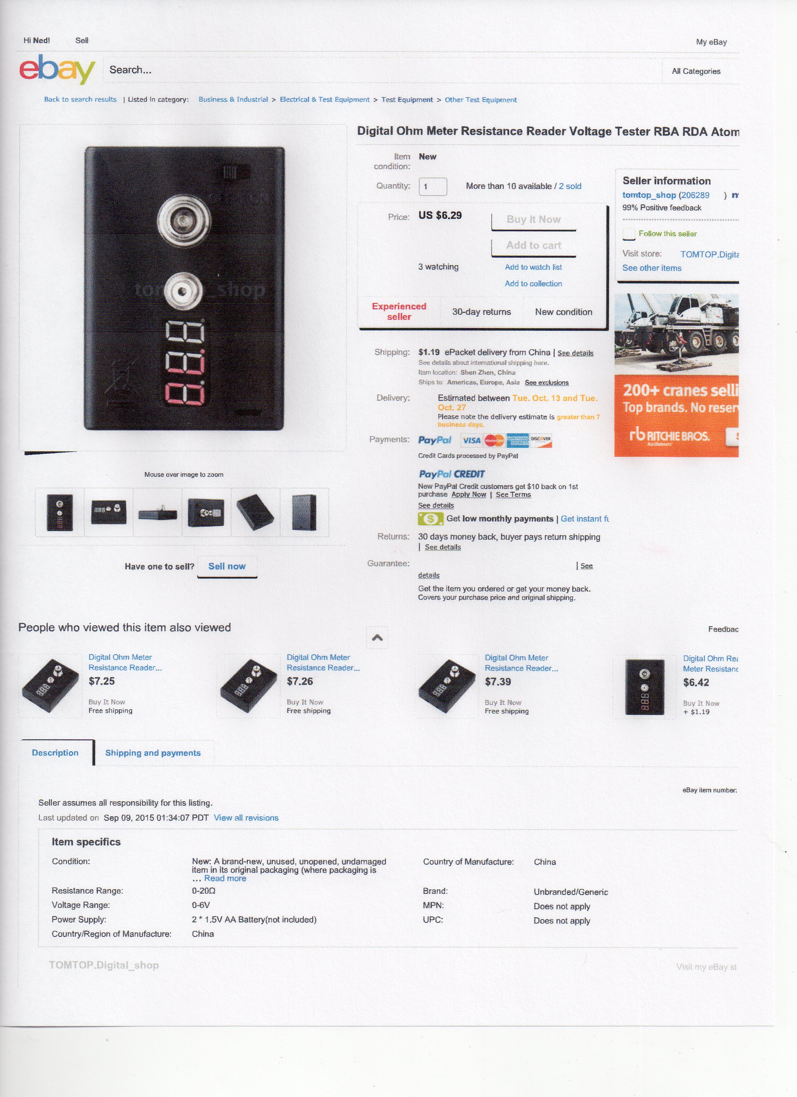

I bought one of the one's listed as per the one photo. I could measure low ohm resistors by touch the center pin and the outside. It seemed hard to handle to me so I opened the case and rebuilt it in another box and the results were great as shown. The resistor is is measuring is a 2.7 ohm resistor. The digits are less than 1/2" high and the circuit works from 12VDC. The last photo is of a EBAY entry that I got the atomizer from.

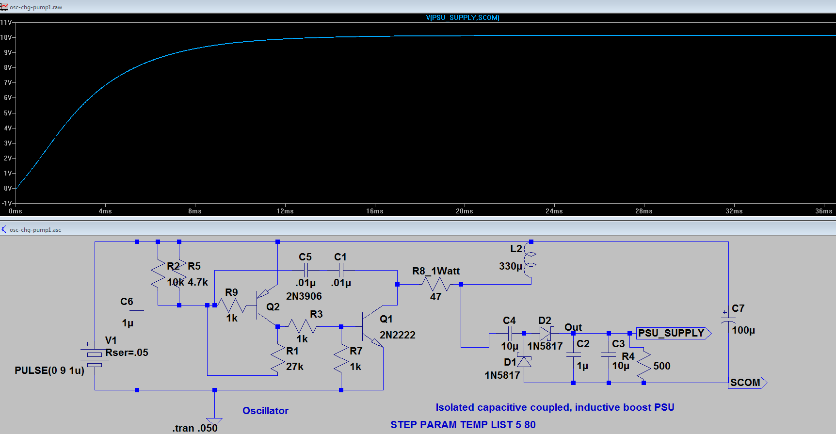

chemelec, please tell me why you would not use one battery for on source of power for the current source and the ohms reading. Thanks
Fairly obviously because they don't (and can't) share power rails - you pretty well always need a separate supply when using digital meter modules (and in fact I've recently bought some little modules which provide an isolated 12V supply from a 12V source for just such a reason).
YES that is Correct

This could make your system run on a single battery: Lower R8 to increase output V based on load.
