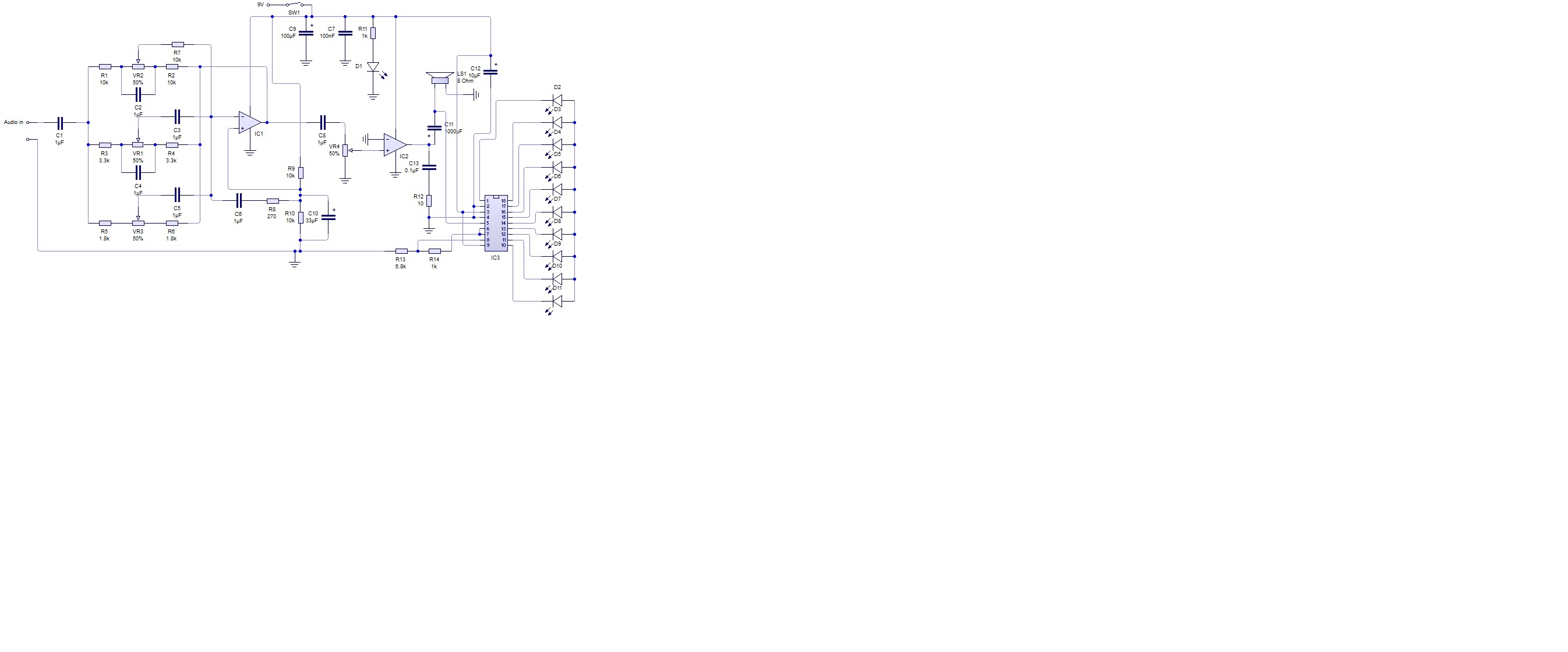

Hi everyone, I'm fairly new to electronics and have built a amplifier circuit with tone control and VU led meter.
IC1 is a LM741 op amp, IC2 a LM386 power amp and IC3 a LM3915 dot/bar display chip.
I combined the LM386 with the LM3915 and added the tone control circuit from a common circuit found all over the internet. I have built the prototype and everything seems to work fine. I get distortin at high levels but I think that might just be the poor performance of the 386 rather than any build problems. As far as 'testing' goes I'm a total amateur so don't know what I should be trying to work out. I know that the gain of the amplifier is 20 but I don't know the impact the 741 circuit will/should have on that.
Any expert help and/or advice would be great.
I have attached the circuit diagram.
The 741 is an old part. There are better "audio" parts. There will be comment from Canada in a little bit about the LM741.
The LM3915 is driven directly by the power amp. (through C11) I need to look at the data sheet. I don't think it is save to drive it to -4 volts like you are doing. We need to think on that a little.
there is a couple of mistakes on component values that I didn't change. C2 - 47nF, C3 - 22nF, C4+C5 - 4.7nF and R11 - 4.7k

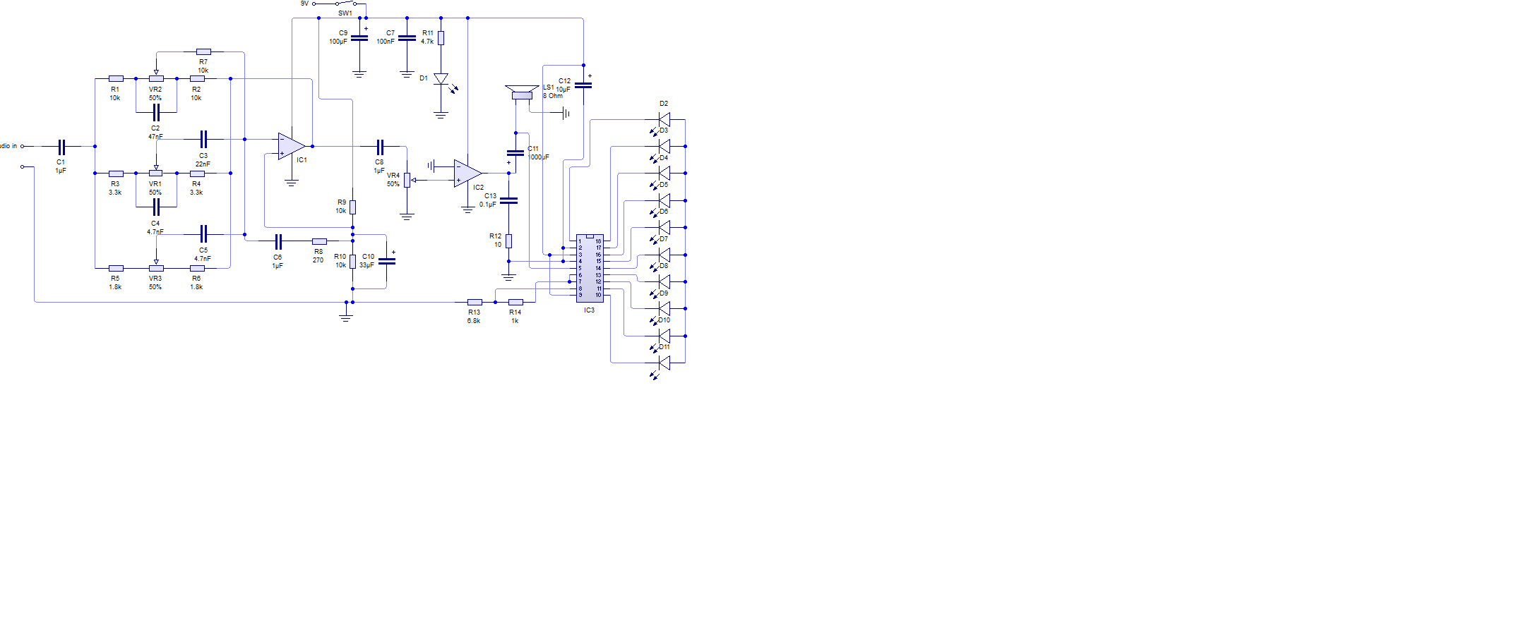

Added a better shot of the circuit diagram. Whilst I appreciate that my choice of IC's may not be the best, they are what I'm working with. I'm not looking to blow Michael J Fox back to 1985, I only want to demonstrate an audio signal that I can control with the 3 band tone and have an output meter. At the moment, and as far as I can see, this appears to work.

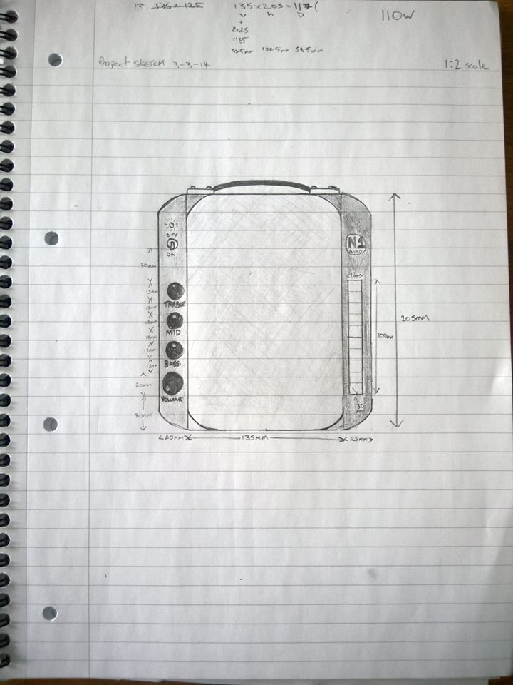

I only need it to perform and function as it should. It is based on a design idea for a small, portable audio amplifier that, for example, could be used to plug an ipod/mp3 player into or as a portable speaker for a laptop. I have added a drawing of a possible unit.

Thank-you for the improved and larger schematic. Your output is 0.45W at clipping when the 9V battery is new which is not loud. If the tone controls are set to boost anything then the average level will be much less if horrible clipping distortion is to be avoided.
The LM3915 has R13 and R14 setting the maximum output to light up to the 6th LED but the 7th, 8th, 9th and 10th LEDs will always be dark. If R14 is changed to 3.3k and R14 is changed to 4.7k then all 10 LEDs will light when the loudness is at maximum and the battery is new. The brightness of the LEDs will remain almost the same as now.
You have pin9 on the LM3915 set for BAR mode which lights all the LEDs at maximum input level which will quickly kill a little 9V battery.

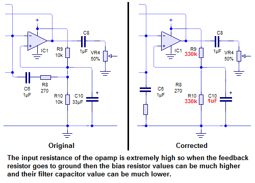

What are C6 and R8 supposed to do?
C6 increases negative feedback at frequencies higher than 593Hz and R8 limits the amount of increase. The reactance of C6 is the same as the value of R8 at 593Hz which allows IC1 to boost 593Hz +3dB and boost lower frequencies at 6dB per octave (bass boost).
R8 should connect to ground instead of to the bias voltage.
What he said ^^^^^^^^^^^^^ Lol!
I have a lot to learn. (Tip hat to audioguru)
Not to question your superior wisdom but the circuit for the tone control seemed a very common and much replicated one. I see none that takes R8 to ground. What impact would that have on the circuit?
R8 has AC only without any DC. When it feeds the bias point then it feeds some upper low, medium and high audio frequency signals into there which is not wanted. R8 should connect directly to ground.

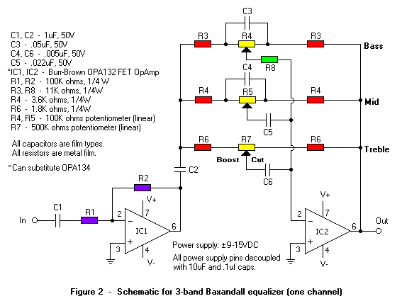

I've done some searching and it looks like this tone control might(I'm certainly not sure!)come from this fellow.
Note that the value of C6 is 1nF,which makes it a completely different animal.Now it looks more like a RF filter.I still would like to know the reasoning behind it.
I am sorry that I might be wrong about the function of C6 and R8 in your tone controls circuit. They might not produce bass boost.
The new circuit that uses only 1nf for C6 might boost very high audio frequencies.
Here is another 3-band tone controls circuit without those two parts:
