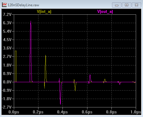

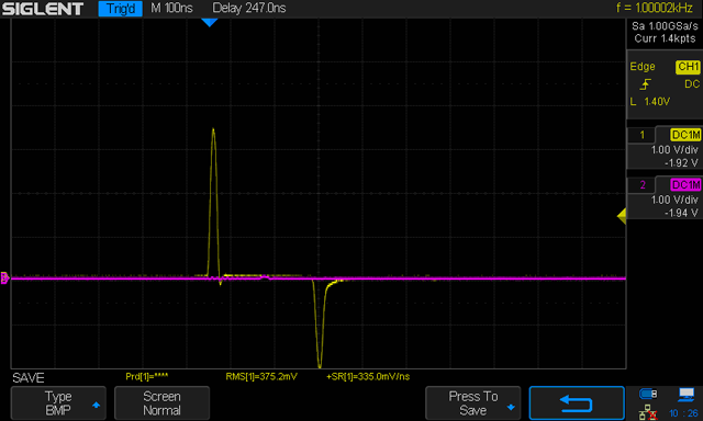

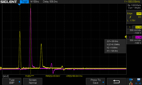

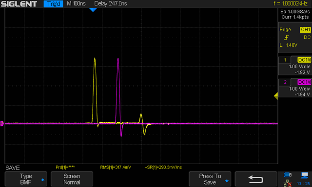

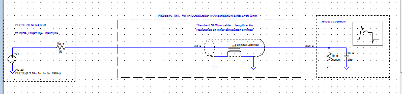

Greetings; I have a delay line from an old Tektronix scope. It is a 120nS delay line. I connected an ARB (with ~8Ns pulse at 1 KHz) on one end (50Ω) and clipped a 1Meg scope probe to other end, yes I know improper match (I wanted to see response of open line). What has me befuddled is the initial pulse amplitude. As seen in image, Yellow trace is input to cable, purple trace is output end. The amplitude for the initial pulse should be same as the purple trace or greater as the cable has attenuation.
Yet, as you can see the input signal is less than the output in fact if you had the second yellow pulse to the first, then you would equal the purple trace.
So we have reflections, but the reflection takes 240 nS round trip to effect the input, so how is it the initial amplitude is as shown below.
Does this make sense? I got myself confused here![banghead :banghead: :banghead:](/styles/default/xenforo/smilies/banghead.png)

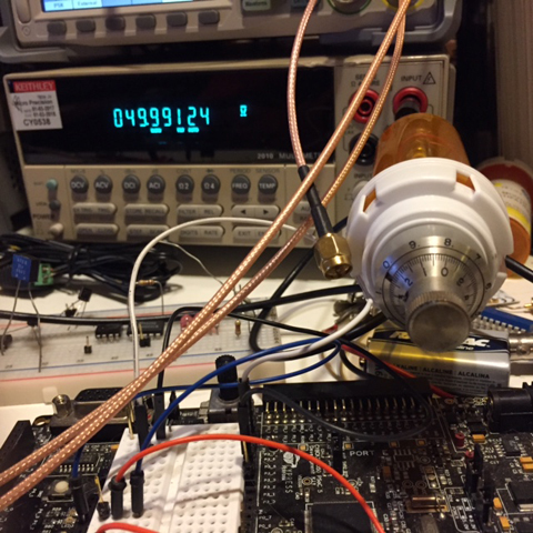

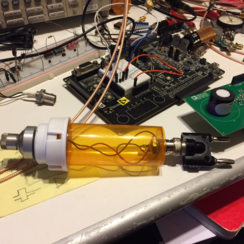

I should clarify. The delay line is actually about 80 feet of twinax cable, I was driving a single wire with shield as ground.I guesstimated 80 feet based on typical numbers of 1.5nS delay/ft for twinax.
