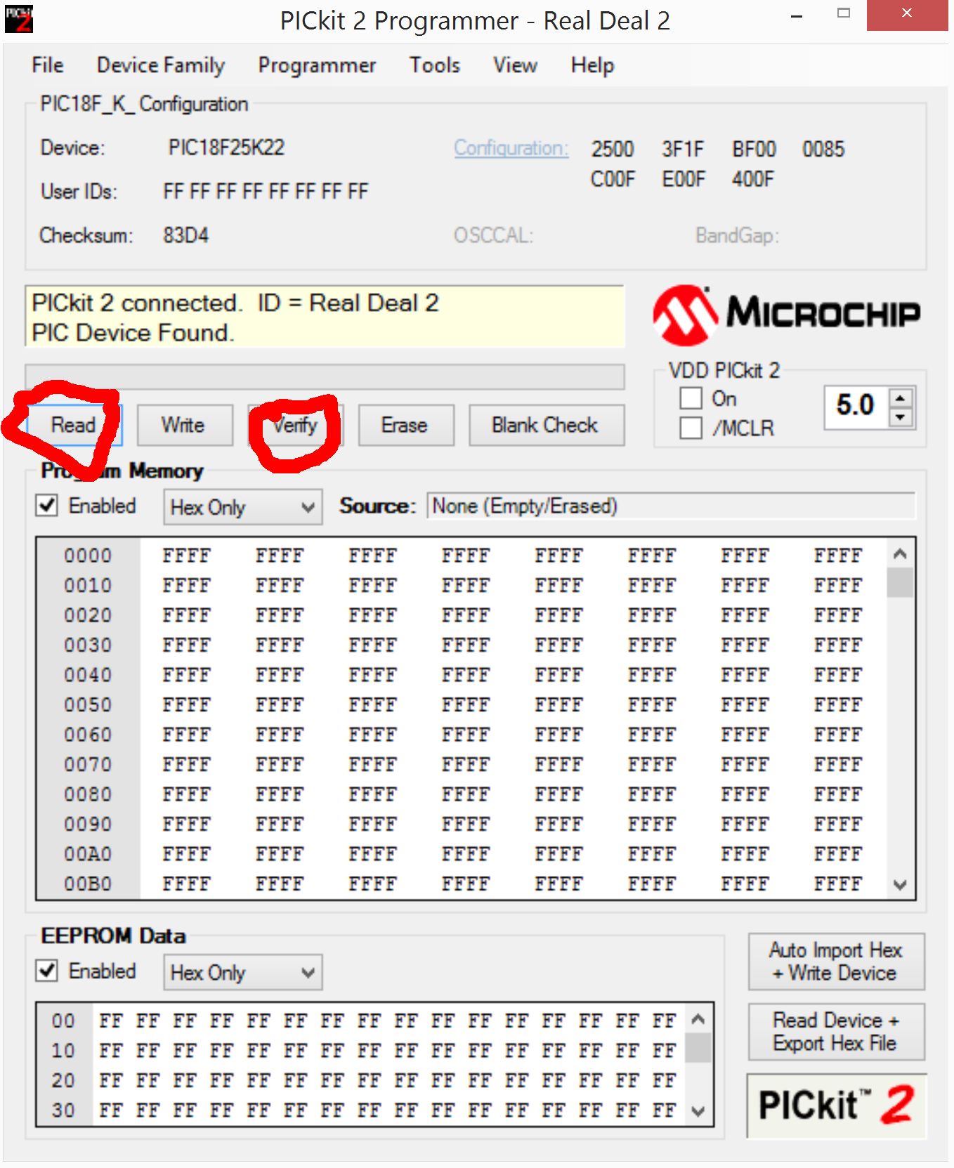

attempted to locate a hex file to program 8 pics but could not locate.
Luckily I have an extra chip that was programmed w/ hex file needed BUT!!
I import the hex file from the pic and a yellow error message says that the file is too large. Went ahead and programmed the pic anyway and it says a successful write to the pic. Powered the pic w/ test board and all seems to work.
Wonder why it had an error about being too large of a file?? or perhaps has something to do with the hex file import??

When you say import, do you mean you read the code from the programmed PIC? There is no option to import from a PIC.
What you could do is read the file from the original chip, and then click Verify on the PICkit 2 GUI. This verifies the file against what's in the chip. If it verifies, it's ok.

....What you could do is read the file from the original chip, and then click Verify on the PICkit 2 GUI. This verifies the file against what's in the chip. If it verifies, it's ok.....
I know you think I type this stuff because I can't sleep or I'm tired of I Love Lucy reruns, but no, the words have specific meanings.
I explained exactly how to tell that tbe code read by the PICkit matches what's in the chip. I would strongly suggest you do this rather then just shrugging and sending the guy crap that may fail under some condition you haven't tested.

the chip is a 18f4321. connected up with 15 leds running on 5v and ran for 10-15 minutes. NO issues arose and the program selection rotary switch worked as did the ACD speed selection pot.
I am still perplexed but it runs with no problems. The hex file shows 91KB
In posts 2 and 4, i outlined how you could verify that the code received by the PICkit matchs what's in the PIC. This minute-long process would let you be certain the code matches exactly.
