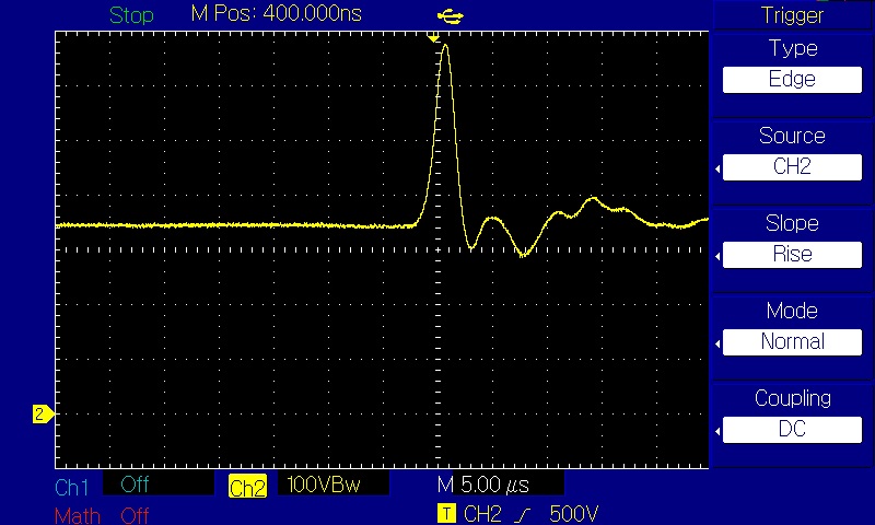

I exposed a 630V rated ceramic capacitor (1812, X7R) to a spike voltage of 680Vpk. (the spike voltage as in the attached)
It did not blow up. In spite of the fact that I exposed it to this spike repeatedly, every 4 seconds, over a 5 minute period. Do you think I have damaged this capacitor in any way?
How long would it be before this capacitor did get damaged, when treated like this?

There's no way to determine how long a component will last when it used outside its specified ratings.
It could be the next spike or it could operate forever.

The aerospace company I worked for would remove your cap in post #1 and replace it just because the reliability was the most important thing. Just in case the cap was damaged.
In my experience, the cap is probably OK and is good for consumer products. I would not keep pounding it with over voltage spikes.
(you can measure for leakage, there is a chance a small hole has formed in the insulation)

I also worked in Aerospace my whole career, and military reliability requirements are that all parts be significantly derated.
If it is a ceramic capacitor, I would also be wary of its value changing. It is well documented that a ceramic capacitor's value goes down (drastically) the nearer you get to its working voltage. I would not be surprised if its value also fell through the floor if exposed to multiple voltage strikes above its working voltage. Not sure, but just an educated guess
But this is because of properties of the dielectric, and I don´t think it is related to electrical overstress. But still the capacity will go down premanently if abused.

The fact is that it does not matter what the capacitor is made of. What maters is how the manufacturer rates their components. If they say the voltage is 100 volts and not to go over that, then that's what they mean. If you go over that then you risk product failure at best, possibly a lawsuit.
Ceramic caps are hardy devices but you cant go over the rating. For one thing, if a particular model was made that was found to withstand 150 percent over voltage repeatedly and then the company finds a cheaper way to make the same cap and starts doing that, future end products could start failing on a regular basis.
