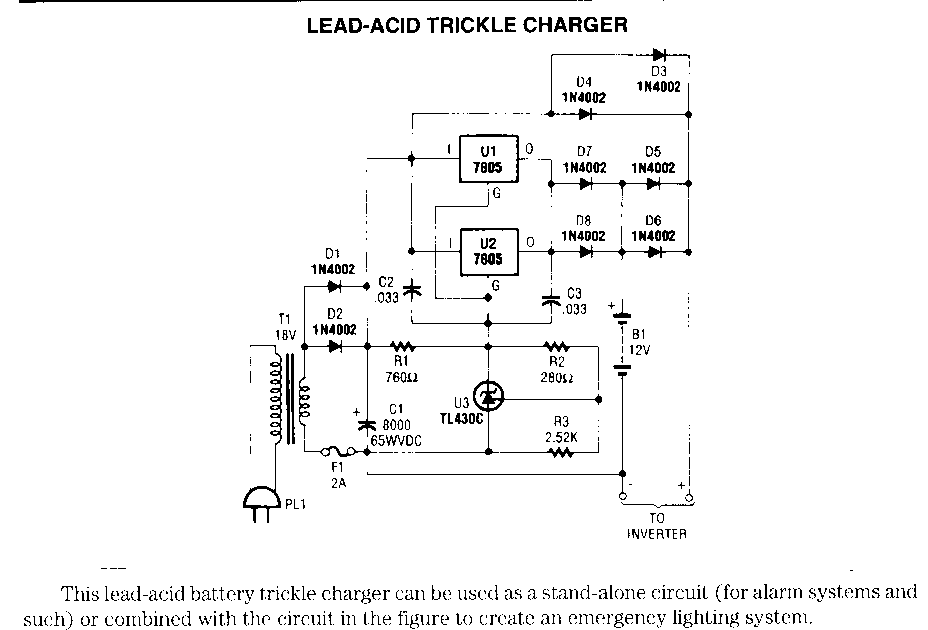

i saw this posted on another forum... basically it just keeps the battery charged, maybe it'll help in some way? not sure what to think of it or how to implement it, and all that there is is this schematic... nothing more. maybe other users on here can give there own intrepretations of it.

John - I'll try to find that site. I think Trini's comments are in line from what I recall. My initial comment was hurried - phone call. I also drew from what I learned, that for a low cost battery the relative cost of the equipment to extend the life might be high enough that it would make more sense to accept the shorter life and replace the battery. Not all batteries are inexpensive. Here in the US I can purchase a battery that is sufficient for my vehicles for about $40 - sometimes less.
