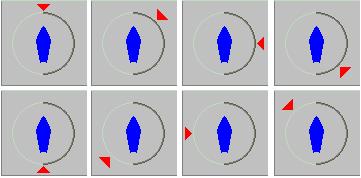

I am looking at doing a project with a color display and i would like to use several backgrounds with as many colours as possible but the 16f877 i intend to use has too little memory to store all the picture data, is there a way to conect external memory to the pic so that the picture data can be stored off pic. a basic answer would be nice with an example diagram if that is not too cheeky :roll: but any input is better than none :p

Ok this is the picture i would like to have as a background and the other will be the overlay it will just tell me the wind direction with reference to the boat the display is 132x132 pixels with a possible 4096 colors.. got the display from www.display3000.com

Why would you want to store 8 nearly similar images in the PIC as the changes is only the little red arrows? You only need to store 4 images of the red arrow(without the ship & background, size 8x8 pixels perhaps) as you can then get the rest from these 4 by mirroring.
Or you can "calculate" the arrow shape using programming and don't have to store anything.
You can also use the Program Memory to store these images if you really "have to store them".

So each picture shod have 17424 pixles.And there are a litle les than 9 colors so its 3 bits per pixel an that makes 52 272 Bits for 1 picture.
So 512Kbit EEPROM cod store 9 such pictures.
Ok eblc138 i totaly agree this was an example set of images only. the images i would like to use are for a management system on board a boat and there are several backgrounds, this was only clear in my first post and the example pictures I chose were perhaps not the best ones, but before i throw myself into doing all the pictures i must find out what the memory constraints of the project will be thus dictating how many colors i can use and how the images will be constructed, as you will may know from drawing pictures in a high resolution then saving them in a low resolution sometimes the picture gets totaly messed up... and that can make you wild if you have spent many hours doing the images :oops: (speaks the voice of experience) , so i thought i would try and find out what memory configurations were available. :D and hopefully how to implement them diagramaticaly.
