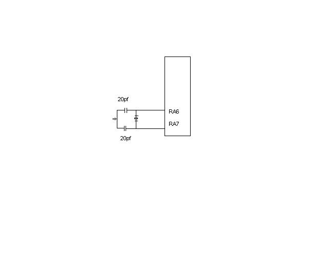

i'm having some difficulty setting up the external xtal working with 16f628.. can anyone help?
i've connected a 4mhz crystal with 2 ceramic 22pf capacitors to RA7 & RA6. The code is as below. the program supposed to turn on PORTB but it didn't.

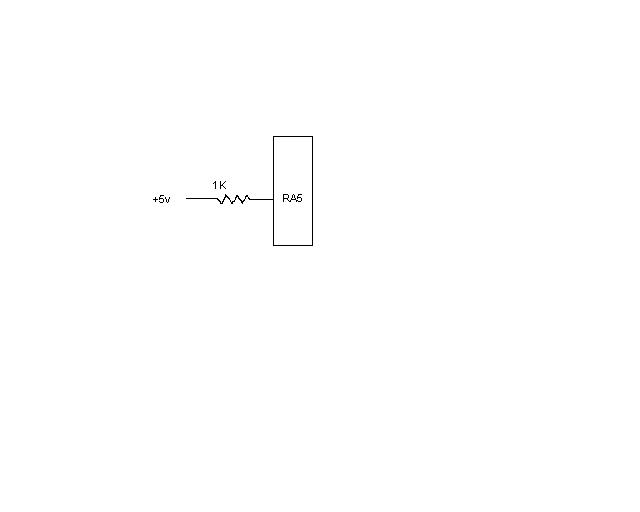

Do you still have PIC16F628? Or it is 628A?
What do you get on PORTB?
Do you have MCLR pulled up? Or you can enable internal pull up in the configuration.
You should disable the comparators if they're not used. That's okay here because you're not using PORTA.

I had a 1k resistor connected from +5v to RA5, is that OK? What else do I need to set up with the hardware?
Yes, I do have resistors for each LED..
edit: have I made the circuit right for crystal?
Everything looks fine to me. Have you checked the connection of the hardware? Have you tried with another PIC?
I think it's a connection problem.. when I pressed the connector wire.. it actually started working.. I think i'll have to rework the board then...
Thanks alot..
