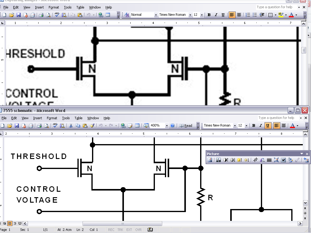

I know about the capture tool which isn't very good because it converts it into a raster image which is hard to edit and will become blury when scaled up. Inskape is better because it extracts the image in a vector format which is smaller and has the advantage of being easilly editable and scaleable.
Zooming in on your Word document causes it to go blury because it's raster, mine stays sharp because it's vector and takes up less disk space.

The problem with that is that a large image takes up lots of memory and there's still the fact that can be harder to edit than a vector.

The example shows a relatively small circuit, already clearly to be seen slightly blurred. (similar to TI-data sheets)
How about a full schematic of DIN-A4 size?
I guess you'd be better off using Inkscape, not more work than cutting and pasting.
